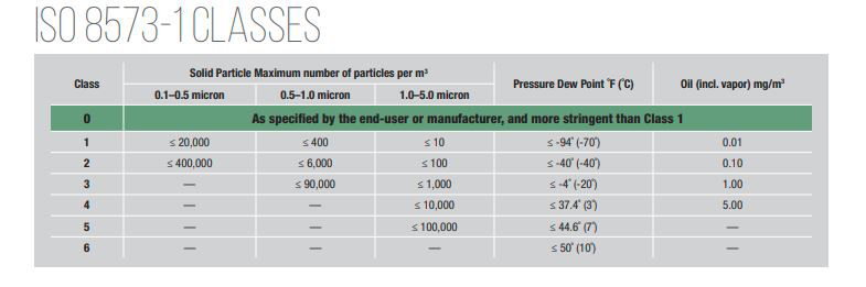

The International Organization for Standardization (ISO) 8573-1 Air Quality Classes outlines the contaminants allowed by class. Oil-free applications require Quality Class 1 at minimum, but preferably Class 0. This is because Class 0 is stable; Class 1 is unstable. Class 1 requires inline filtration to eliminate the oil content coming from the compression process, and the filtration depends mainly on two variables that affect the performance of the filtration process: compressed air pressure and compressed air temperature/ambient temperature.
Class 0 air is more stringent than Class 1 (0.01 mg/m3 of oil as contaminant), as agreed upon between the manufacturer and the user.
The lower the class, the lower the concentration of oil contaminant is in the compressed air, and the lower the risk of other contaminants.
Figure 1: Breakdown of the ISO 8573-1 classes. Courtesy: Sullair
The ISO 8573-1 standard consists of purity classes for contaminants in compressed air: particles, water and oil. The ISO 8573-1 purity classes can be used to describe the quality of a compressed air system or to specify the required quality for a precise application.

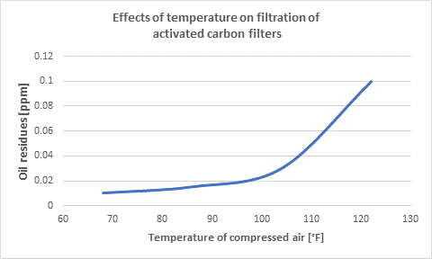

For example, consider a 1000 cfm oil flooded machine. It releases about 14 gallons of oil downstream per year (at 86°F and 3 mg oil/m3 of carryover on oil separator). At minimum, three filters are needed to remove the oil, including activated carbon filtration for oil vapors – but this can be a risky and precarious proposition, and here’s why. The performance of inline oil filters decreases with the inlet temperature.

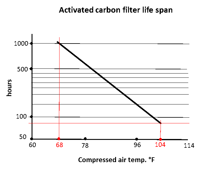

Downstream filters are specified at 68 to 70°F (20 to 21°C) of compressed air inlet temperature. This is a very precise situation. If this is not the case, the performance of filtration decreases exponentially at higher temperatures (see graph #2). Imagine what happens if the compressed air reaches 80°F or 100°F or more. It can easily happen because the compressed air temperature at outlet of the compressor is approximately 27°F over ambient temperature. Here is what happens: as the temperature increases, the potential of oil going downstream significantly increases. This means oil can get into the equipment and contaminate the end product, production equipment and the environment.
Figure 2: Effects of temperature on filtration of activated carbon filters. Courtesy: Sullair

A filter’s lifespan is short. If the user consistently maintains 68-70°F (20-21°C), the activated carbon filters – which remove oil vapors up to 0.01 mg/m3 – will last a little under six weeks (41 days). With any temperature shifts to around 100°F, the lifespan of the activated carbon filter could be less than four days (90 hours).
Variation of temperature makes oil-free Class 1 unstable and means air quality can easily jump from Class 1, or “technically oil free,” to Class 2, which doesn’t even qualify as oil-free air.
Class 1 is not always technically oil free because the quality/performance of filtration depends on the temperature of the compressed air. The higher the temperature, the more the compressed air quality decreases. The compressed air can jump between Class 1 to Class 2 depending on the temperature.

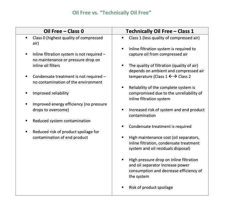

What is the difference between Class 0 and Certified Class 0 air?
Class 0 meets ISO 8573-1 requirements. Certified Class 0 has been certified by an outside lab to ensure compliance with all Class 0 requirements. Certified Class 0 is like getting an extra check on the air quality by a 3rd party.
Table 1: Differences between class 0 and class 1 oil free and what they mean for manufacturers. Courtesy: Sullair
