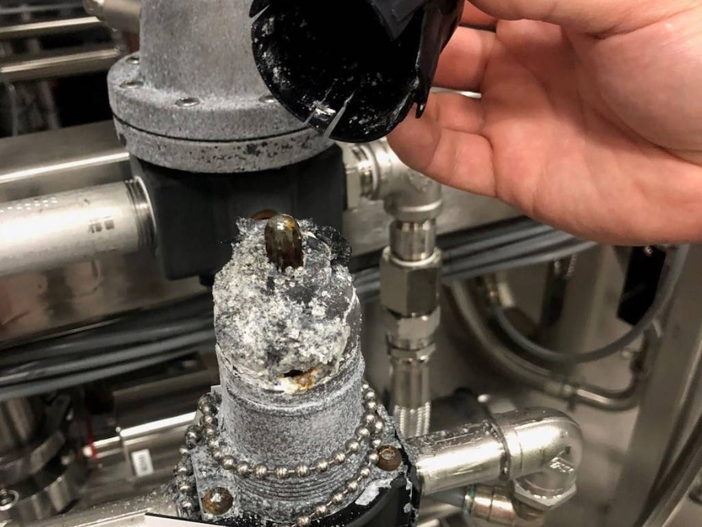

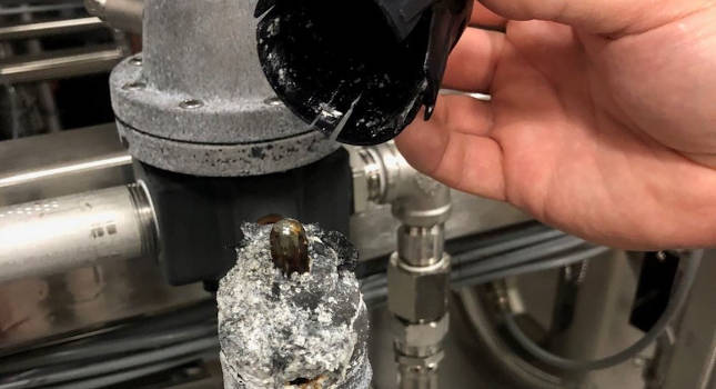

Consider carbon dioxide, which is commonly used for refrigeration, cooling and casting. In this case, a pressure regulator was badly corroded and no longer functioning (see Figure 1). The regulator was connected to equipment that used compressed air, nitrogen and carbon dioxide. Because there were no visible or easily detectable issues with the equipment, the team continued to swap out the damaged pressure regulator for a new one, only to have that one fail shortly after.
Using an acoustic imager that could “hear” leaks beyond human capability, a small carbon dioxide leak was discovered near the pressure regulator. Over time, this type of leak can cause components to break (or corrode), negatively impacting uptime and/or quality. Compressed gas leaks like this are the root cause of many component failures that often go unnoticed.
Figure 1: A failed pressure regulator damaged from a nearby gas leak. Courtesy: Fluke

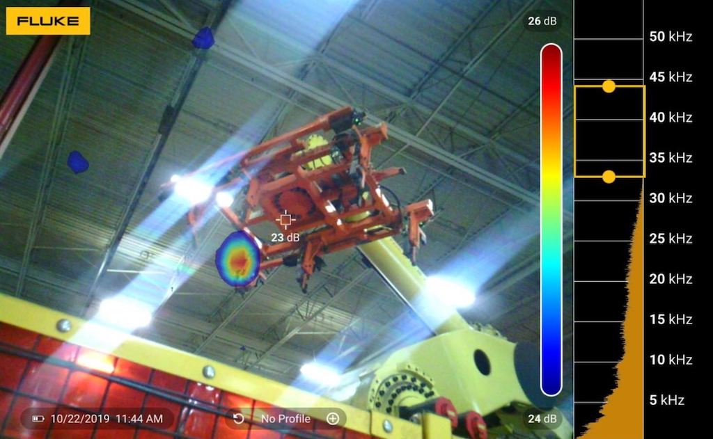

Consider the example of a pick-and-place robot with pneumatic cups. The robot picks up materials or products from one location and moves it to another location for continued processing. If the suction or actuator is weak, picked parts could drop or not be placed in the right position, impacting product quality (or creating a complete loss). Often, when suction issues are reported, all components are replaced because it is too difficult to isolate the problem. Rather than needing to check each cup independently, the entire robot could be scanned with an acoustic imager to identify exactly which cups need replacing to avoid damage (see Figure 2).
Figure 2: A pick-and-place robot with pneumatic suction cups. The Fluke ii900 Industrial Acoustic Imager captured air leaks in one suction cup from the ground floor. Courtesy: Fluke
