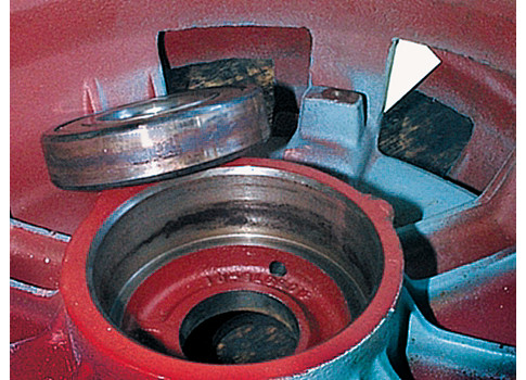

The same principles apply to bearing housing bores. If the fit is too tight, the bearing can be damaged during an aggressive assembly attempt (i.e., a large mallet). If it is too loose, there may not be enough friction between the outer race and the bearing housing bore to prevent movement ranging from micromotion to the bearing spinning in the housing. It is also possible for the fit to be within tolerance at ambient temperature but expand at operating temperature, allowing the bearing outer race to move, especially with aluminum housings.

Micromotion occurs when a variable load is applied and there is room to move. Though limited to an extent by the fit tolerance band, it can still happen under the right conditions because the housing bore is loose by design.
Radial load tends to inhibit micromotion, and a strong, consistent radial force can “pin” the bearing race to the bore. But the weaker the force, the greater the likelihood that the micromotion will occur (e.g., a perfectly aligned, direct-coupled application theoretically would have no radial load).
Micromotion causes fretting (mechanical wear at the surface), which will appear as small rusty patches on the bearing inner or outer race, or on the housing or shaft (see Figure 2). Because the oxidized areas are usually harder than the bearing surfaces, fretting can accelerate mechanical wear. Under the right circumstances, fretting can occur on either fit. Bearing fits are critical to the reliability of rotating equipment. Application conditions including the type of driven load, the connection to that load (direct coupled or belted), and the proper bearing for the application are all factors to be considered in achieving the correct fit.
