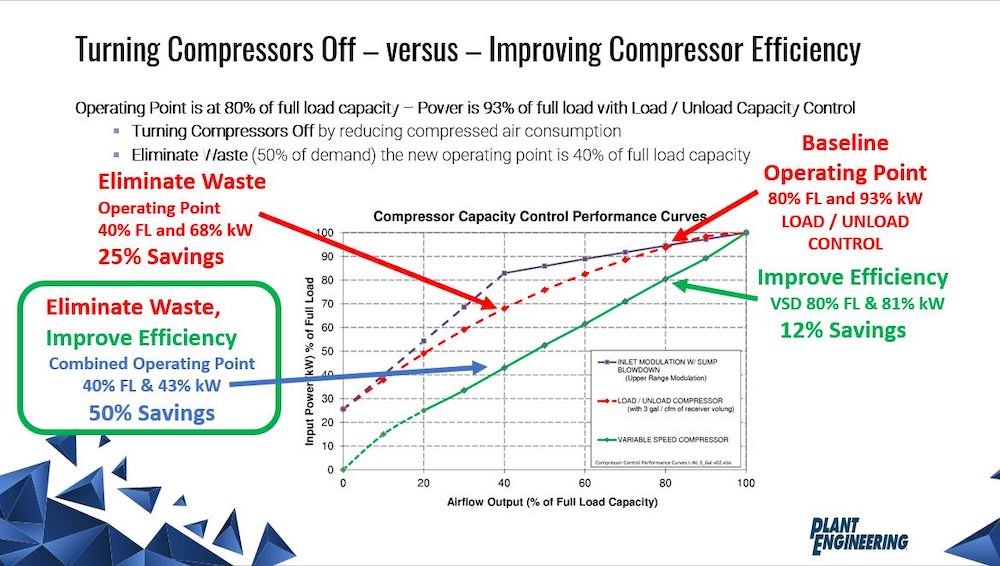

Tom Taranto: Now, we’re comparing here three different control types in Figure 4. The red dotted line is the load-on-load control. The top line is inlet modulation with unloading when it gets to 40% of full capacity. The bottom line is the best available part-load capacity control of a variable speed drive compressor. What we want to talk about here is: What is the difference between turning a compressor off or improving compressor efficiency?
Courtesy: CFE Media
Courtesy: CFE Media
Well, if we look at an operating point of 80% of full-load capacity, we see that with both modulation and load-on-load control, we’re still pulling about 92% of full-load power. Whereas if we go to variable speed drive control at 80% capacity, we’re probably pulling 81% or 81.5% of full-load power. That’s a 12% savings by simply improving the type of part-load capacity control that we’re using.
Let’s consider what happens if we fix leaks, eliminate artificial demand and we eliminate waste of air in the system. What does that do for us? Well, if we eliminate 20% of waste in the system, now remember, we talked about the pie chart and we think about half the year is wasted. If we simply go from 80% capacity on this compressor down to 40% capacity, look at what happens?
With the load-on-load control, we’re down below 70% of full-load power and that is 25% savings. How do we get such a great savings? Well, when you compress air, 85% of the energy that the compressor uses goes to overcome the heat of compression. The single biggest energy gain you can make in a compressed air system is avoiding the compression of a cubic foot of air.
When we eliminate that waste, now we’re at 25% savings versus 12% savings by improving the efficiency. I’m going to eliminate waste, avoid the compression of all the air I possibly can and I’m going to use a good, efficient part-load capacity control and I’m going to get 50% savings.
This is where you get to something that we talk about the synergistic effects of measures that you implement in a compressed air system. It is the sum of the two parts here is 37%, but because of the synergy between reducing the amount of air we’re compressing and improving the capacity control, we’ve netted a 50% savings by combining the synergy of both of those measures together. That’s what we’re looking to do.

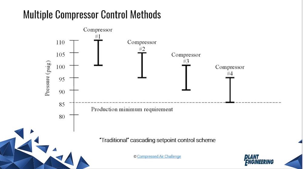

Eric Bessey: We probably don’t want compressors to run all the time. There are low loads, weekends, holidays where we only need a little bit of air. The traditional method was to set the compressors up into what’s called a cascade range.
Courtesy: CFE Media
Courtesy: CFE Media
You can see that on the far left of Figure 5, if I need very little air, I can get by with one compressor, but the pressure is going to be higher. Then as I take air out of the system, the pressure drops. We’ll pick up No. 2 at about 95 psi, we’ll pick up compressor three at 90 and then finally, No. 4 at 85 psi. Now we have what’s called the minimum production requirement of 85, so I certainly can’t drop below that.
But you can see that this presents a couple of different problems about energy and waste and that is problems with traditional control. That is we can end up turning on more compressors that we need. Those compressors that are running, are going to operate in part load according to that performance curve. You might have two or three compressors that are operating very inefficiently.
Maybe they’re operating at part load, they’re throttling maybe or other various wasteful forms. One thing that should be considered, is multiple compressor control systems. We get into the concept of let’s have a maestro orchestrate all our compresses together. Let’s perhaps consider operating fully loaded, a lot of compressors and maybe we only provide a trim or part-load machine with one or two compressors.
Compressors are most efficient operating at full load, if they must operate at all. Of course, if you can shut them off, that’s good too.
