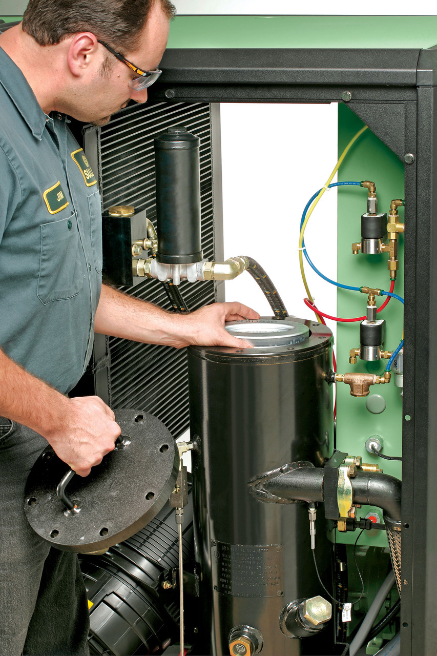

air compressor
Maintaining a sequence checklist will keep your air compressor running at its highest efficiency. Courtesy: Sullair, LLC
6. Dryers, filters and clogs.
If the company doesn’t have an automated air monitoring system, create a sequence checklist to ensure the compressor is performing at its optimal level each day. Check filters and review the differential pressure gauges to determine if there are any clogs hampering the machine’s performance. High performance equals energy savings.
