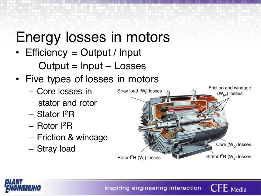

Question: How can we measure efficiency of installed motors?
Answer: A wattmeter and a torque transducer of precision and accuracy beyond what is currently available would be needed for accurate measurement of installed motor efficiency. Thus, the practical answer is there presently are no accurate methods to measure installed motor efficiency.

Q: Does motor load affect power factor (PF)?
A: In general, reducing motor load reduces PF and increasing load increases PF. However, since motor power is affected by the combination of voltage, current and PF, an increase or decrease of PF alone (or voltage or current) does not in itself indicate a change in motor efficiency.
