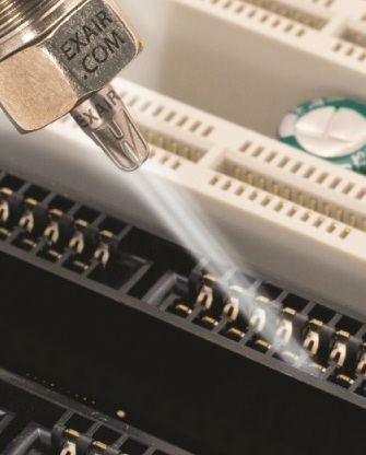

The Model 1108 SS Atto Super Air Nozzle has been engineered for precise blowoff with efficient, high-volume, high-velocity airflow. The nozzle measures only 0.5-in. with a diameter of only 0.16-in., permitting installation in tight spaces. High amplification of airflow and a strong blowing force of 2.0 oz are achieved with minimal air consumption of 2.5 SCFM at 80 PSIG. The airflow cannot be blocked, which meets the OSHA standard for dead-end pressure, 29 CFR 1910.242(b). Sound level is low at 58 dBA, which meets OSHA noise requirement 29 CFR 1910.95(a) and is CE compliant.
