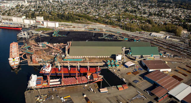

QCA Systems LTD selected an industrial, built-for-purpose, in-chassis PLC module that acts as the messenger between the PLC and enterprise system using structured query language (SQL).
Neptune Bulk Terminals handles a large portion of the Canadian steelmaking (metallurgical) coal exported to overseas markets annually, and it is an important contributor to the Canadian economy. Reducing environmental impact, costs and processing times are high priorities across the supply chain.
However, an inability to know or control real-time status and real-time routing can lead to inefficiencies, taking the form of missing customer commitments, lower capacities, higher costs and avoidable shutdowns. Streamlining delivery of this information often involves bridging the gap between operational technology (OT) and information technology (IT), enabling users to maximize efficiency and boost visibility across the shipping plant.

In this application, steelmaking coal comes in from cargo trains, is processed on-site and loaded onto large Handymax or Cape-size vessels. Inside the terminal, shipments are processed through a network of conveyors that must accurately move the coal to and from the cargo transports. The conveyor system, which consists of multiple routes, is crucial to the successful distribution of shipments to the target destinations.
However, these routes are subject to change. Variables such as the volume of imported coal, different grades or load capacity of vessels, can influence the path of a shipment, causing it to deviate from the predetermined route. The shipping plant needed the most accurate real-time information available to successfully adjust its procedures to these evolving circumstances.
Although PLCs stationed along the conveyor routes control the movement of coal, in the event of a process interruption, there was no visibility into a faulty conveyor’s real-time status. There was also no visibility into other nearby conveyors with spare capacity, and no visibility into the higher-level business system, which managed the entire process and logistics.
