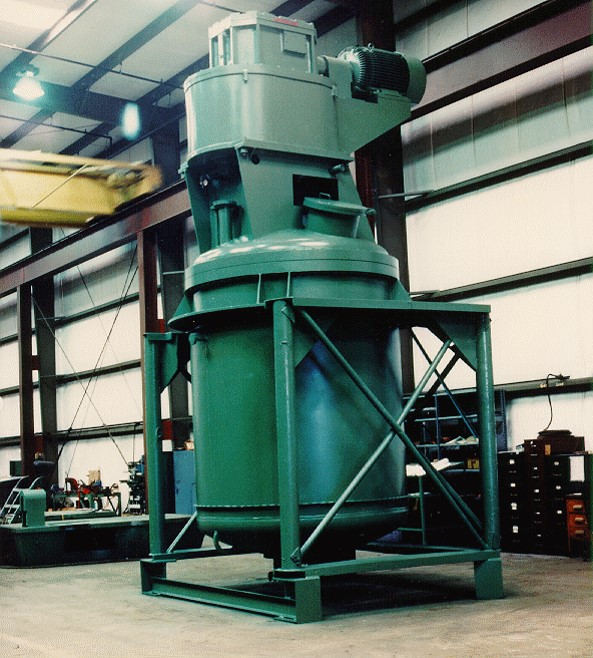

Grease can be manufactured in many types of equipment, including open (atmospheric) kettles, closed (pressure) kettles, Stratco Contactors and continuous manufacturing units. Mixing configurations, heating/cooling media and age of the equipment all vary considerably.
Grease kettles may be pressurized or unpressurized and are used to manufacture greases, a lubricant.
Grease kettles may be pressurized or unpressurized and are used to manufacture greases, a lubricant. Courtesy: NLGI
In all cases of manufacturing, process variables must be maintained to produce the desired thickener and finished grease. It the case of open kettles, pressure kettles and the Stratco Contactor, the time-temperature profile is of utmost importance. The proper temperature must be reached, in the prescribed time period, for the reaction to occur correctly. In addition, the temperature differential between the jacket and the batch, the rate of addition of fluid, the order of addition of the additives, the severity of homogenization, among other process variables, can all affect the outcome of the manufacturing process.
In the case of the continuous process, the maintenance of process variables such as temperature, pressure, differential pressure and flow rates all affect the properties of the final product. Each variable must be maintained in steady state during the course of manufacture to produce a grease with consistent properties.
