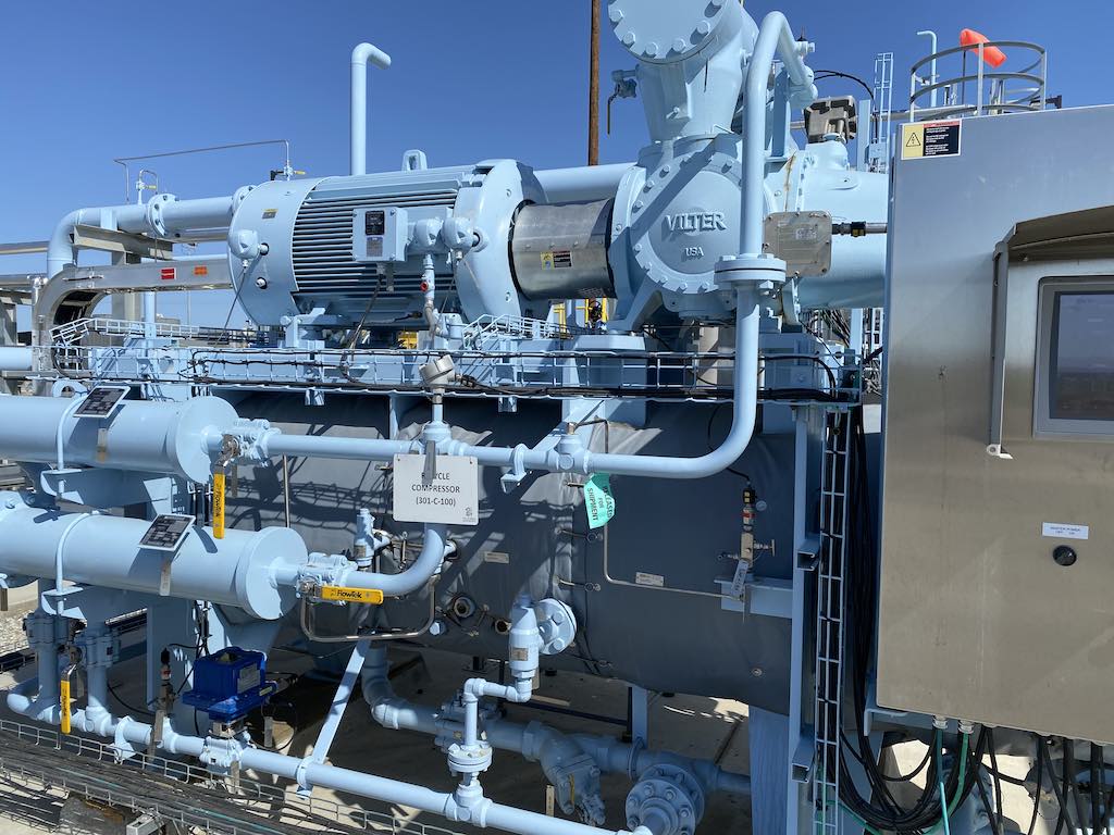

Figure 2: Example of a 300hp 3600rpm TEFC methane compressor pulling methane out of dairy farms and compressing for a pipeline in California. Courtesy: Nidec Motor Corporation

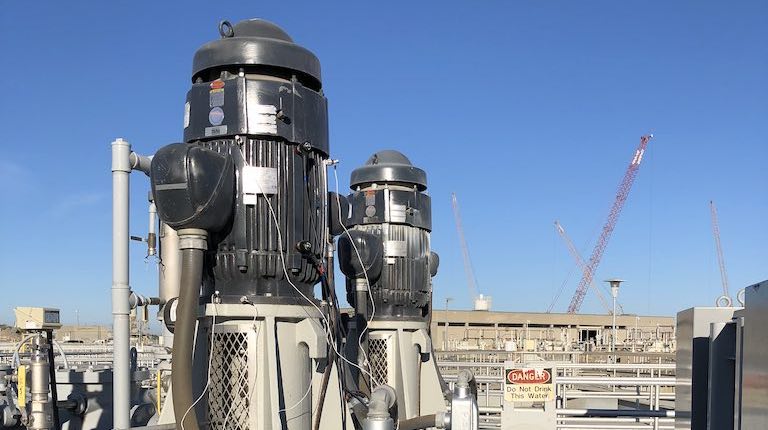

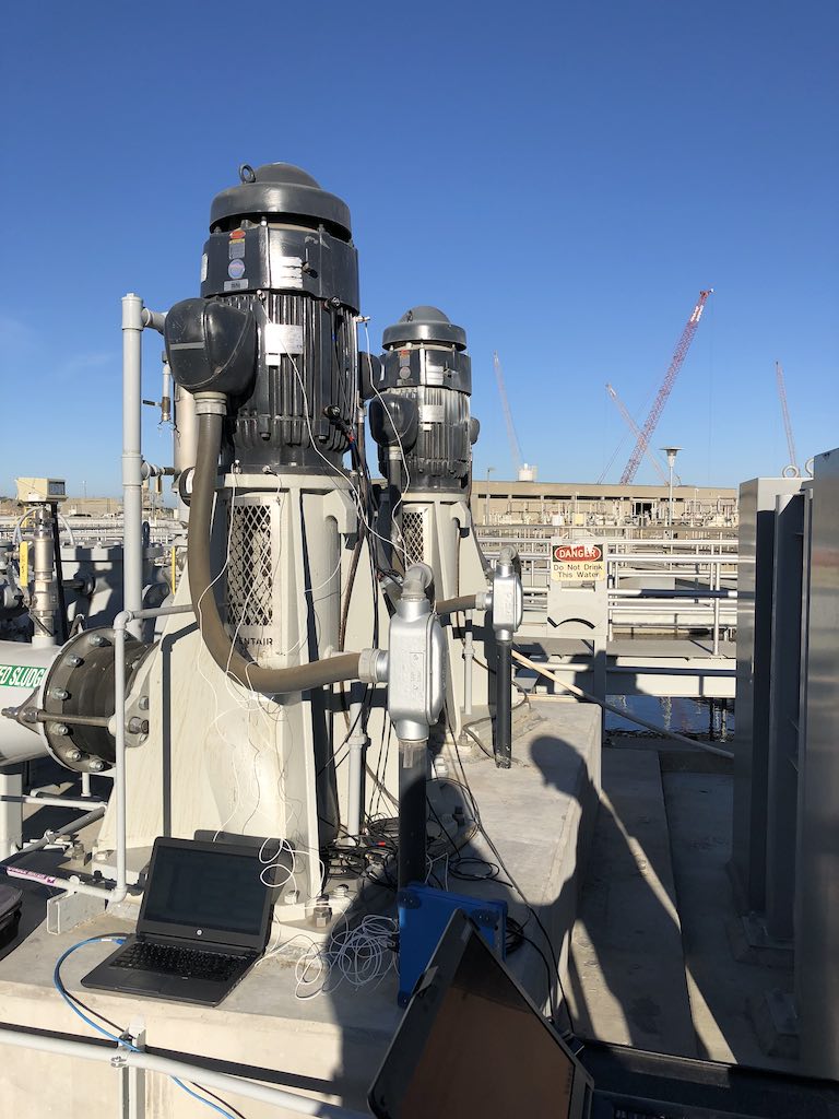

Figure 4: Example of a 30hp Vertical normal thrust in a wastewater treatment plant in California. Courtesy: Nidec Motor Corporation
