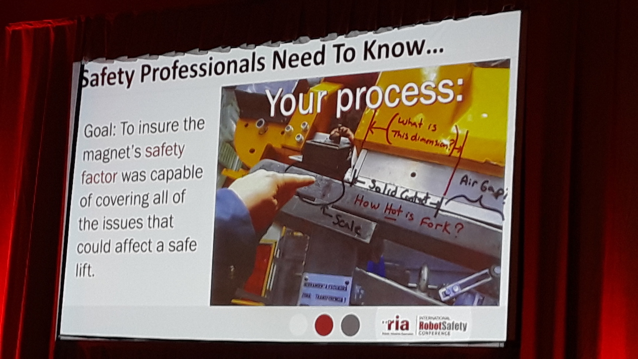

Robotic safety shouldn’t be a reactionary afterthought, said Jeff Pratt, Crown Equipment, senior corporate EHS Engineer (and vice-chair of the RIA R15.08 standard development committee), and César Reyes Núñez, Crown Mexico, EHS coordinator. A Crown risk assessment team works to ensure safety is designed into the process. In examining a workcell (Figure 2) where a robot gripper dropped a large fabricated fork after it came out of an oven, nine outcome branches were identified to ensure that accident wouldn’t happen again. A proximity sensor was applied to the gripper and the robot was reprogrammed to not rotate the fork in a shear (weak) position for the magnet. No fork has been dropped since.
