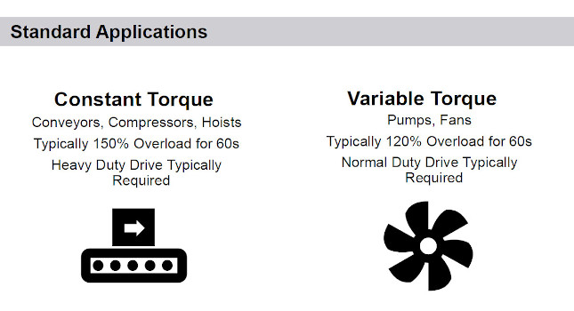

When specifying an adjustable speed drive (ASD) – also known as a variable-frequency drive (VFD), variable-speed drive (VSD), and/or inverter – first look at the application of the motor with which the ASD is to be used. Constant torque applications, such as conveyors, lifting equipment, compressors, or crushers, among others, usually specify a severe-duty or heavy-duty drive. In variable torque applications, which include centrifugal fans and pumps, a normal duty drive will suffice.
Severe duty drives often have a current overload rating of 150% for two minutes and can run continuously at 115% current. Drives with a heavy-duty rating have a current overload of 150% for one minute and can run at 100% current continuously. Normal duty drives are robust enough for fans and pumps since they have a current overload rating of 120% for one minute and can also run at 100% current continuously.
