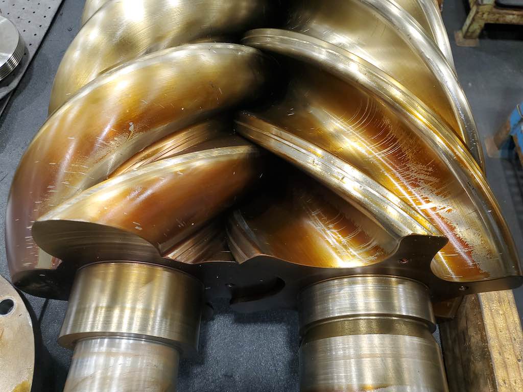

Figure 2: Varnish on an air compressor’s rotors can occur when the wrong lubricant is used or if the lubricant isn’t changed at regular intervals. Oil sampling can help identify when it is time to change out the lubricant. Courtesy: Hitachi Global Air Power
Residual used oil left in the compressor from the last oil change will increase the rate of lubricant degradation. It is important to drain as much used oil out of machine as possible before adding fresh oil into the system.
Additive depletion is another cause of degradation. Lubricant additives are chemical compounds that improve the lubricant performance. Most additive packages in lubricants are designed to be sacrificial and are used up during the life of the lubricant.

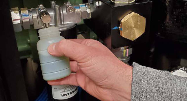

Four oil sampling best practices
The most effective predictive maintenance programs include an oil sampling program to monitor lubricant conditions and identify any potential threats to the equipment. Oil sampling helps maximize asset reliability and bring cost savings to a company’s bottom line. To receive the most out of an oil sampling program, it is valuable to implement a few best practices in the oil sampling technique.

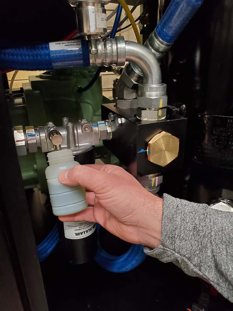

  1. Proper sampling techniques include running the compressor up to normal operating temperature before taking the sample. An oil sample should never be taken while the lubricant is cold. This will help to ensure the oil is well mixed with no idle particulates or water.
  2. Preparing a clean area for the sampling is also a best practice. The fluid sample valve must be clean and free of debris before draining the sample into a clean new bottle.
  3. The most important step in the oil sampling process is recording all the data about the sample. To aid in the oil sample report analysis, it is best to record accurate information about the sample such as type of lubricant, hours on oil, compressor hours, serial number of the machine and the date of sample.
  4. Consistent oil sampling frequency is vital to any good maintenance program. Predicting a failure with oil analysis is about having the opportunity to witness the root causes or symptoms as they develop. Consistent sampling frequency allows the maintenance professional to investigate historical trends and monitor how the lubricant is responding to its environment over time.
Once the sample is taken, it should be sent for lab analysis as soon as possible. Prompt analysis can provide time to act before expensive repairs or unplanned downtime occur. Maintenance professionals can determine what action is needed once the oil sample report is received. The next steps are not always crystal clear from the oil sample report, but looking for a few simple results can help provide a suggested course of action.

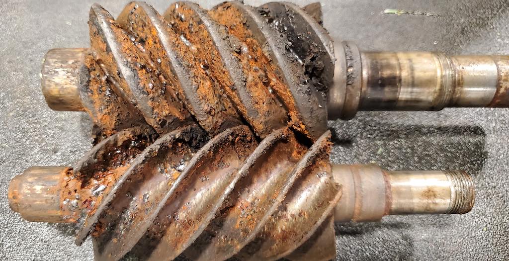

Figure 3: Example of what happens to air compressor rotors when lubricant has failed and the compressor is running on water. Courtesy: Hitachi Global Air Power
