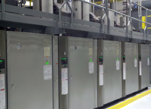

Modern on-demand systems can go from ice cold to red hot in just about five minutes—which significantly reduces the amount of lost fuel and energy anticipating arrivals. They are ready to go when you need them.
Just as important, these units achieve even greater efficiency due to their modular design: They can share capacity for load demand among multiple compact units. If comparatively little capacity is needed, fewer boilers can be activated. If more steam is required, you simply activate more boiler modules. Even if the terminal operator doesn’t know whether an incoming train will contain 30 cars or 120 cars, not only can he control when to start them up, but can control the exact energy and capacity needed on a case-by-case basis.
In addition, when the demand for steam power rises and falls while workers are attaching and detaching the steam hoses to and from the train cars, modular, on-demand boilers can respond much more quickly and efficiently. They offer the same operational efficiency regardless of load. Low-fire or high-fire, it’s all the same. In contrast, a conventional boiler has a four-to-one turndown with a severe impact on efficiency below 50% firing.
Of course, many rail terminals operate with redundancy in the event of a system failure or simply to assure the ability to unload oil quickly without paying penalties to any parties involved. With conventional boilers, redundancy represents a major investment; from the hardware itself, to space requirements and fuel costs if multiple units need to be run simultaneously.
On-demand systems also are more efficient simply by the nature of their design. While a conventional boiler will lose 240,000 Btu/hr. through its exterior, on-demand units lose just 60,000 Btu/hr. when fully operational. That’s a significant difference. Imagine leaving your car running overnight to be ready for you in the morning: that should help you visualize the amount of energy wasted with traditional units.
On-demand boiler systems are managed by a master controller to help achieve further energy-efficiency. The controller uses a sensor to monitor steam demand, automatically bringing the boilers online, regulating their output, and shutting them down as they are needed. Advanced software is used to send commands to individual terminals to adjust the boilers’ operation for maximum overall efficiency.

The compact size of on-demand systems also offers design flexibility that is simply not possible with larger systems. On-demand boilers require only about half the space of conventional boilers. They also do away with the space requirements of standard tube-pull and door-swing designs.
