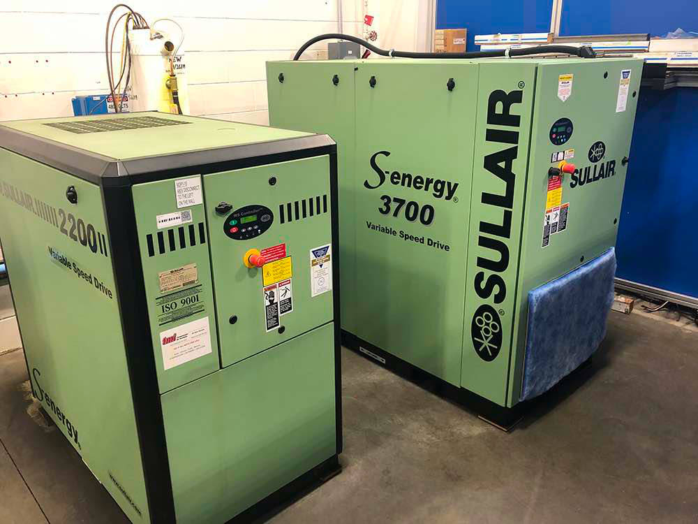

Variable speed drives (VSDs) are electrical components and do require regular care to operate optimally, including cleaning cooling fans and heat sinks regularly. Courtesy: Sullair

4. Variable speed drive (VSD): With a VSD, the motor speed automatically adjusts to increase or decrease compressed air production based upon changes in demand. This direct connection to the compressor motor means the most precise correlation of production to demand among available control methods. Using our earlier automobile analogy, the VSD acts like smooth gas pedal operation – gradually increasing and decreasing speed.
VSDs are electrical components and do require regular care to operate optimally, including cleaning cooling fans and heat sinks regularly. VSD performance also can be impacted by dirty environments and altitude.
