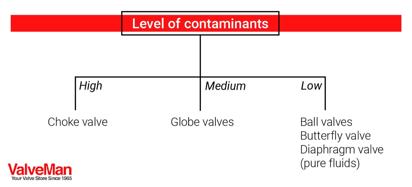

The first thing process engineers must evaluate before settling on a specific valve type is the quantity of contaminants in the service fluid. They must analyze the fluid’s physical and chemical properties to quantify the levels of contaminants. Contaminant levels fall into high, medium or low categories. A choke valve will be the most viable option for contaminated viscous fluids. Other options include ball valves and globe valves.
Valves explained
Figure 1: Choke valves are best at controlling the level of contaminants. Courtesy: ValveMan
Ball valves provide excellent flow coefficients and induce minimal pressure drops on the system, making them the preferable flow control devices for viscous fluids and slurries in most industrial and oil and gas operations. They have smooth and unobstructed flow paths, as well as superb sealing characteristics that extend throughout their service life. For ball valves, pressure drops occur between the ball and the seat of the valve.
Some ball valves utilized for viscous fluid service contain liquid O-rings to enhance their sealing properties. Advanced ball valves use perfluoro alkoxy alkanes/polytetrafluoroethylene (PFA/PTFE) for their constructions to avoid O-ring sealing.
Diaphragm-type valves provide good flow coefficients, but they rank lower than ball valves. The design and construction of the diaphragm valve aim to limit contamination and the accumulation of solid particles around the valve body. It uses a metal pin to connect the membrane of the valve to the actuation system. The contact between the membrane and the valve seat creates an airtight seal. These valves are common in high-purity fluid applications because of their rapid shut-off, precise actuation capabilities as well as their cleanliness.

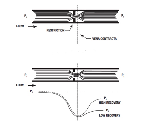

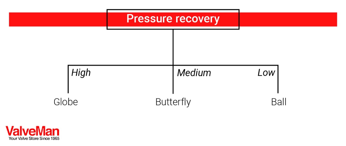

The other factor to consider in the selection process is the desired pressure recovery factors. Valves with low-pressure recovery protect piping systems from the dire effects of flashing. Engineers will settle on ball valves if the piping system in place has low levels of contaminants, requires medium precision control and pressure recovery is low.
Figure 2: When it comes to pressure recovery, globe-type valves are the best option. Courtesy: ValveMan
When selecting valves, engineers have to predict the possibility of flashing occurring in a control valve. They rely on the pressure recovery factor that compares the pressure drops across the inlet and the outlet of the valve against the pressure drop from the inlet and the minimum pressure point of the valve. A valve with a high-pressure recovery factor is prone to flashing. The pressure recovery factor relies on the style and design of the valve. Valves with convoluted fluid paths present more opportunities for the dissipation of energy, which causes significant pressure losses.

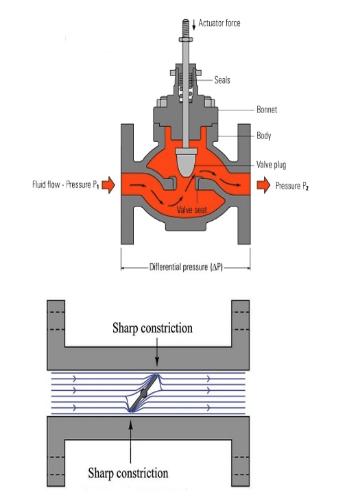

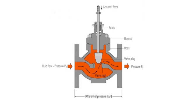

By comparison, globe valves distribute pressure losses better than butterfly valves. A globe valve has several constriction points that facilitate even distribution of the effective system pressure drops. For a butterfly valve, the pressure drops occur at limited constriction points between the valve body and disc. Butterfly valves recover fluid pressure and have a lower pressure recovery factor, making them unsuitable for the conveyance of viscous fluids with lower vapor pressure limits.
Figure 3: Fluid flow constriction points a globe-type valve (top) and butterfly valve (bottom). Courtesy: ValveMan

Figure 4: Pressure recovery profiles for high (top) and low (bottom) recovery valves. Courtesy: ValveMan

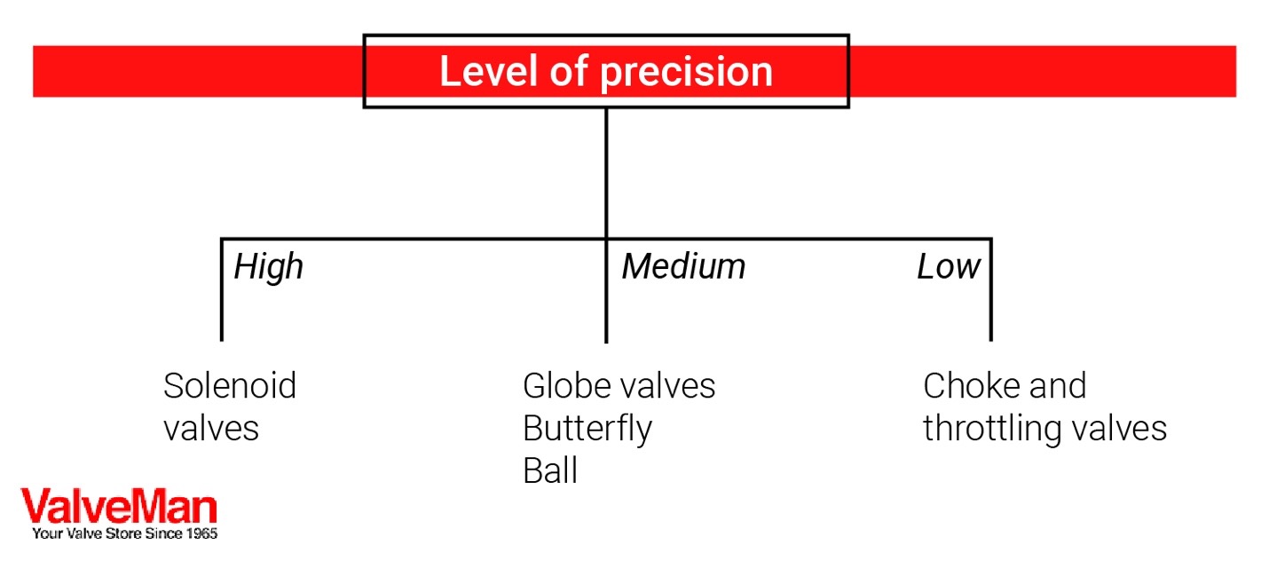

The other thing engineers evaluate during the valve selection process is the level of desired precision. High-precision flow processes often require automated valves that respond to flow conditions. Fluid flow processes requiring the highest levels of precision will utilize solenoid valves.
Figure 5: When it comes to precision, solenoid valves are the best option. Courtesy: ValveMan
Some high-precision pipeline systems transport highly-viscous fluids under high pressure. These systems must maintain constant flow rates and retain minimal pressure drops across the valves. Most of these automated piping systems use solenoid valves that capitalize on the weaknesses of conventional quarter-turn valves.
