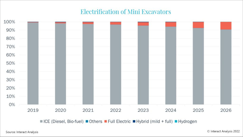

Some vehicle OEMs have begun to electrify certain portions of their portfolios and have made significant progress in evaluating hydraulic system redesigns. One example where electrification is beginning to emerge is in electric mini excavators. We estimate the market for hydraulics sold to this vehicle type to be approximately $1.6bn in 2021. Given the size, these vehicles will be a fertile testing ground for new hydraulic technology. The rate at which mini excavators are going electric is shown below.
Electrification of mini excavators.
Electrification of mini excavators. Courtesy: Interact Analysis.
