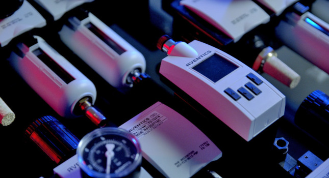

Given a comprehensive portfolio of devices, connectivity tools and analytics capabilities enable digital transformation across a machine, system or an entire facility. Courtesy Emerson

A flow sensor can continuously monitor airflow in pneumatic systems, providing operators with clear, actionable insights regarding flow, pressure and temperature. Courtesy Emerson
