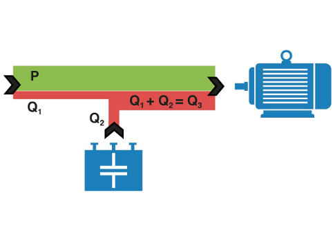

Capacitor sizing: When sizing the capacitors, select values that will minimize the risk of excessive voltage, as well as transient currents and torques. With the capacitors installed (see Figure 3), the reactive power (Q1) required from the bus is the difference between the motor’s reactive power demand (Q3) and the reactive power supplied by the capacitors (Q2). To balance performance against the risks associated with over-excitation, it’s typically desirable to raise the power factor to 0.90 or 0.95.
As an example, consider a three-phase, 250-hp, 460-V, 277-amp, 4-pole induction motor with efficiency (eff) of 96.2% and a power factor of 0.88. To determine the capacitor rating needed to raise the power factor to 0.95, first calculate the real or input power:
Next, since the existing power factor is 0.88 = cos (φ1) and the new power factor is 0.95 = cos (φ2), we find φ1 = 28.36 deg and φ2 = 18.19 deg. The correction capacitor rating will be equal to the amount of locally generated reactive power (Q2) needed to raise the power factor to 0.95:
For any phase angle φ1, the value tan (φ1) is the ratio of reactive to real power (kvar/kW). Thus multiplying P by the ratio Q/P above leaves Q (the reactive power). For convenience, some common values of [tan (φ1) – tan (φ2)] are supplied in Table 1.Select the nearest standard rating to the calculated value.

To determine the effect of improved power factor, calculate the total current (I) required from the system before and after correction:
For the above example, the current decreased by 21 amp, or 7.6%. It’s important to note that power factor varies with load, so these values would only be valid for the loading used for the calculations.
