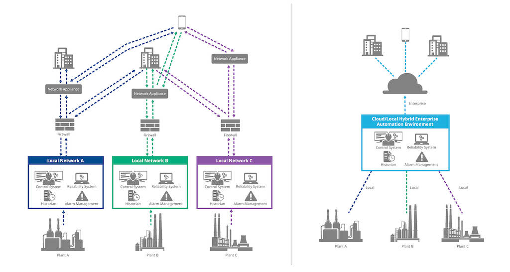

Implementing this type of holistic automation platform requires the creation of a more software-defined infrastructure. Such a design allows the automation system to handle data more efficiently so it can grow into an enterprise operations platform that will also perform control functions. Technologies such as wireless communication, advanced physical layer, software-defined controllers, OPC UA data integration, module type package, and edge gateways enable teams to create expansible enterprise systems covering more plants, all while implementing uniformity and standardization that acts as a foundation for success in the future.
Figure 1: A single holistic automation system, with some technologies deployed within the enterprise IT edge and others in the cloud, dramatically reduces complexity to promote data democratization, fleet optimization, and improved productivity. Courtesy: Emerson

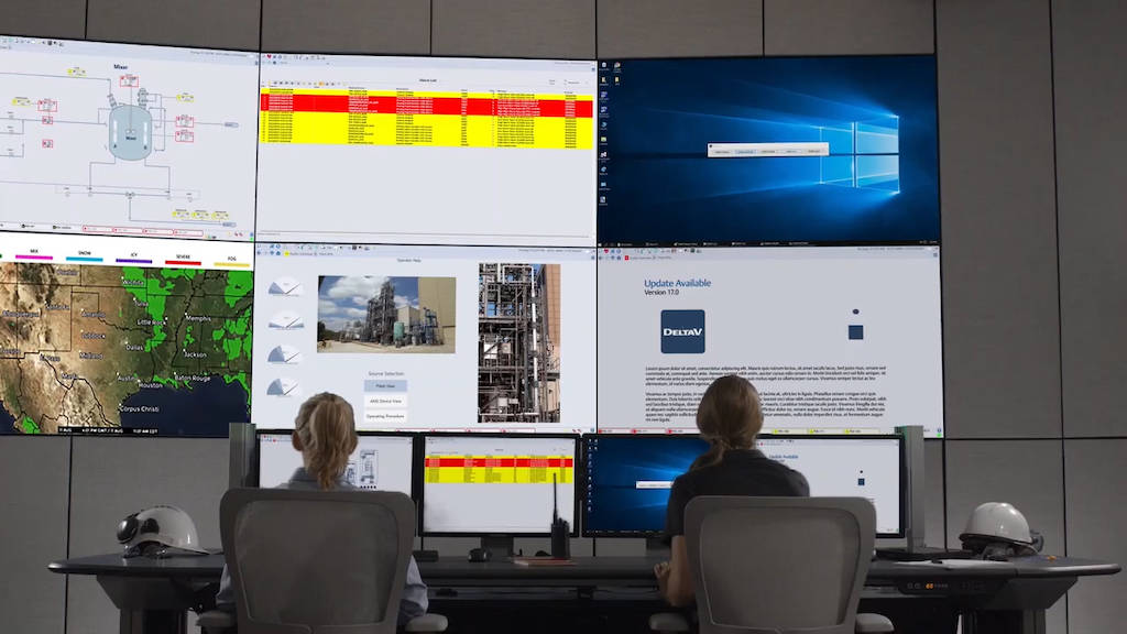

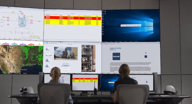

But when process manufacturers apply a holistic approach to automation, the benefits multiply. Enterprise historians and the ability to move contextualized data out of plants and into data lakes enables teams to move automation optimization from a localized function to an enterprise-wide integrated operations vision. Process manufacturers can operate a central team of experts that monitors every plant across the fleet at an enterprise level. Instead of needing a hard-to-find and hard-to-retain expert at each site, local technicians are supported by global experts with full visibility to plant operations in real-time (See figure 2).
Figure 2: Moving to a more holistic automation strategy helps companies with limited personnel centralize expertise by establishing integrated operations centers to support a wide array of facilities across the enterprise. Courtesy: Emerson
