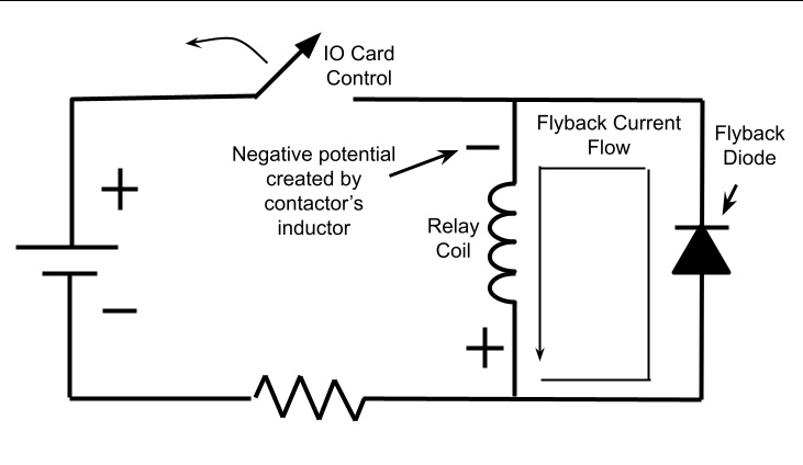

1. Overvoltage protection
A flyback diode protects the circuit from overvoltage if the contactor is switched off from a controller. Without it, the magnetic field around the inductor collapses and produces harmful voltage levels. Aside from damage, higher voltage generates noise that confuses the controllers, which can trigger false trips.
The basic configuration of a flyback diode for industrial applications is to use a classic rectifier in reverse polarity across each contactor terminal.
2. Four flyback diode considerations
Flyback diodes relieve the magnetic circuit of its energy in a reverse flow system. When inserted into a circuit, the diode creates a reverse current path to flow through it .
While the application is simple, there are four parameters to consider when choosing a diode that helps mitigate damage to the diode, controller and contactor:
  1. Selecting a proper reverse voltage (V) that is suitable for the application.
  2. Selecting a current (I) that can support the application.
  3. Selecting a repetitive energy (J) dissipation for the application.
  4. Ensuring that the diode is as close to the target as possible.
Several factors must be considered before committing to the purchase of a diode. These include reverse voltage rating, current and energy, which will prevent long-term damage to the contactor.
Figure 1: Flyback electrical circuit. Courtesy: Hedgehog Technologies

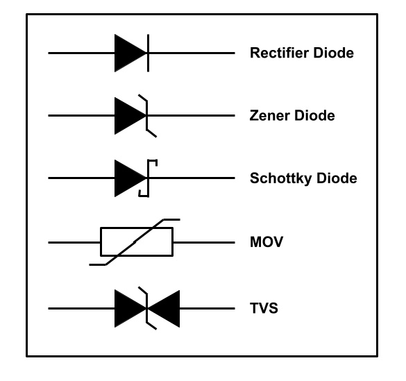

Four alternative flyback diode control options
There are several options that can be considered as alternatives to a basic rectifier diode and each are useful in specific applications.
  • Metal oxide varistors are used in ac circuits operating as logarithmic functioning devices. They are useful in protecting them from severe spikes that occur in events such as lightning strikes.
  • Transient-voltage-suppression diodes are fast-acting diodes that can be bi-directional or mono-directional to protect electronics from transient spikes. While they can be used in flyback applications, they cost more than a basic rectifier diode and may not be required in a typical contactor situation.
  • Zener diodes are reverse triggered for a set voltage. Though they are not intended for surge protection, they can work if a suitable part is selected.
  • Schottky diodes carry a low forward voltage drop thus increasing the opening time of the contactor. This diode is not recommended as the reverse voltage tolerance is lower than typical rectifier diodes.
