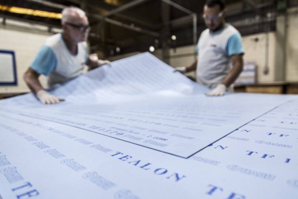

Flexible graphite, for example, is a popular choice for applications running at higher temperatures (above 500°F). These gaskets are also highly compressible, allowing them to conform to flange surface imperfections.
Figure 1: Depiction of gasket material before being cut into gasket. Courtesy: TEADIT
However, flexible graphite sheet gasket materials generally exhibit limited recovery, meaning that once they are compressed, they do not rebound. Gasket recovery is critical in cycling applications and therefore is a primary consideration for these services. The use of graphite for facings and fillers in semi-metallic gaskets like spiral wounds or corrugated metal gaskets take advantage of the temperature resistance of the material, while at the same time adding robustness that leads to better recovery.
