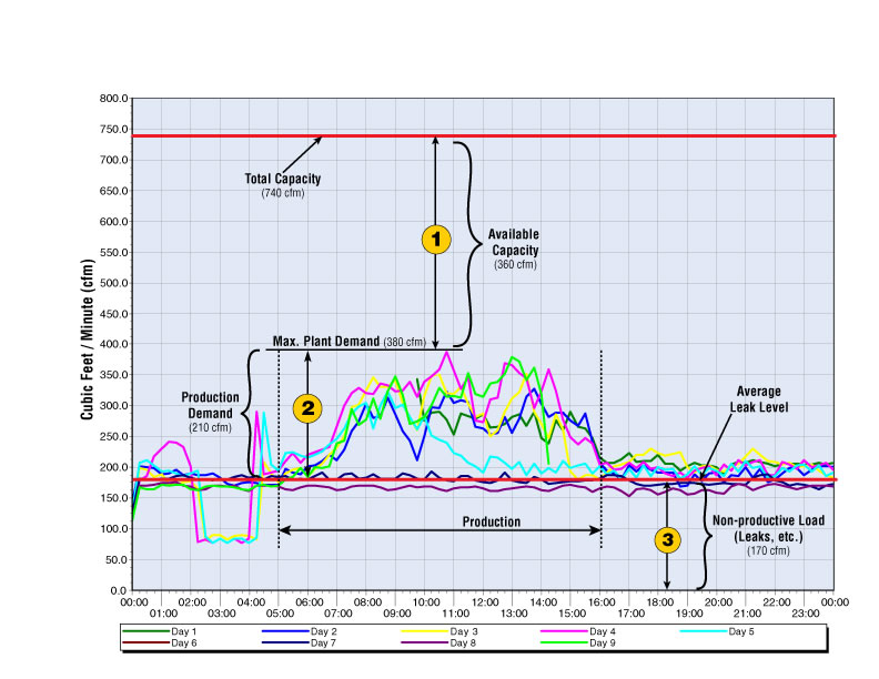

Leaks are in effect just another user of compressed air. Ideally, plant operators would review all compressed air uses and reduce or eliminate inappropriate uses before conducting audits that influence changes to the compressed air supply. But the reality is that often it’s the audit that first alerts the user of significant leakage. The following chart from an actual compressed air audit showed that this plant was losing 170 cfm to leaks—this accounted for 45% of their total 380 cfm demand.
