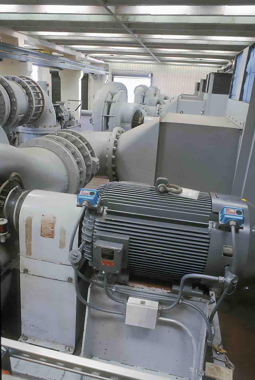

Figure 1: Example of an application with a grease-lubricated ball bearing motor driving a blower. Courtesy: EASA

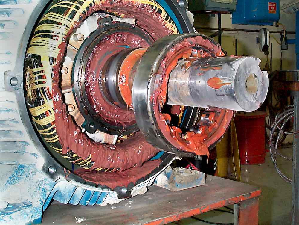

Figure 2: The low viscosity of this lubricant was caused by mixing incompatible greases. Courtesy: EASA
Various special characteristics of grease — such as temperature range limits, mechanical stability and water resistance — mostly depend on the type of thickening agent used. For example, sodium-based greases generally provide poor water resistance, while greases with polyurea and other nonmetallic soap thickening agents usually have superior high temperature properties.

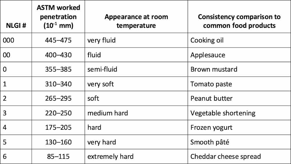

Grease consistency: Consistency indicates the hardness and fluidity of grease based on penetration units and NLGI (National Lubricating Grease Institute) consistency numbers. As Table 1 shows, each NGLI number covers a range of penetration values. The higher the number, the harder (firmer) the grease and the better it stays in place, which is useful where leakage is a concern. A lower NLGI number indicates a softer grease that flows better. Rolling element bearings use NLGI 1, 2 and 3 greases.
Table 1: NLGI consistency and comparison numbers. Courtesy: EASA
Grease penetration values depend mostly on the base oil viscosity and the percentage of base oil in the lubricant. Penetration is the depth, in tenths of millimeters that a standard weighted cone sinks into grease under prescribed conditions. High-viscosity oils tend to stiffen greases and decrease penetration values, so they work well for heavier loads. They also make greases less susceptible to atomization and thinning at higher temperatures. Low-viscosity oils increase grease penetration values for use with lighter loads and lower temperature applications.

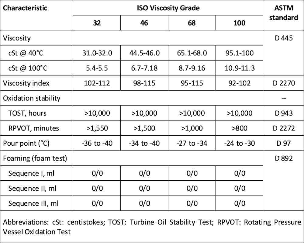

Table 2: Typical characteristic properties of a turbine oil. Courtesy: EASA
Lubricant manufacturers or blenders typically use qualification testing to ensure that lubricant blends meet the stated minimum criteria. Table 2 lists some of the more important and useful characteristic properties of turbine oil, including:
  • Viscosity: Considered the most important property of a lubricant, viscosity provides a lubricating film, cools machine components and seals and controls oil consumption. Liquids that resist flow or flow slowly, such as honey or dish soap, have high viscosity. Liquids that flow easily or quickly, such as water or vegetable oil, have low viscosity. The viscosity index (VI) is the rate at which the viscosity of an oil changes with temperature. The higher the VI, the less the viscosity of an oil changes with temperature.
  • Oxidation stability: Oxidation stability is the ability of a lubricant to resist chemical combination with oxygen. If that occurs, it can create sludge deposits and increase the viscosity of the oil. Heat, light, metal catalysts, acids formed by water contamination and other contaminants can accelerate the oxidation rate.
  • Pour point: This is the lowest temperature at which an oil will flow under prescribed test conditions. The number of wax particles that remain after crude oil processing determines the pour point. The more particles there are, the higher the pour point. The fewer there are, the lower the pour point.
  • Rust resistance test: The rust resistance properties test measures the ability of industrial oils to prevent rust in water contamination situations.
  • Foaming characteristics test: The foaming characteristics test empirically rates the foaming tendency of lubricating oils and the stability of the foam.
