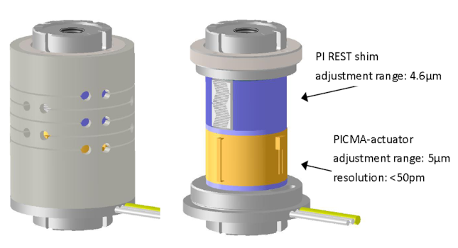

Figure 6: Hybrid combination of traditional piezo stack actuator for highly dynamic motion (bottom, orange) and programmable shim (top, blue). Courtesy: PI[/caption]
If required, active shims also can be combined with classical piezo actuators (see Figure 6). Typical applications for these types of hybrid systems include dynamic vibration compensation, readjusting the focal plane during an optical measuring or scanning process, as well as controlling a laser beam in metrology systems or materials processing.
