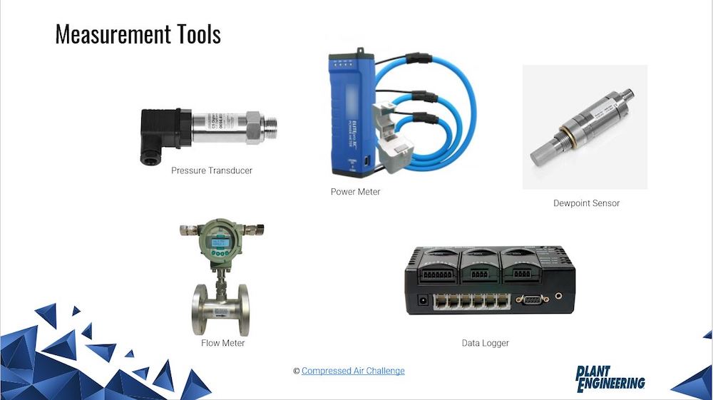

Eric Bessey: Perhaps one of the key things that people struggle with is just basic understanding of what information they need to gather to analyze their compressed air system. Just like any big system, you might consider your house heating, for instance. It starts with an analysis of what it is that’s being used and how it’s being supplied. Then with that knowledge, you can look at how improvements may be made.
For compressed air, the key things are:
  • What the airflow is.
  • How much air are we using?
How much air are we using and at what pressure? Then how much is this costing us? Air is expensive and there are ways to reduce the air consumption, power consumption and save energy. With the measurements that we take, we can develop profiles called baseline profiles to determine what average airflow profiles are being supplied and being used by the plant.
We will also understand what various pressure profiles there are through the plant, get an idea of how the pressure is being used throughout the plant, how it might vary through time and so forth. Eventually, getting down to the ultimate operating costs is the answer. There are several measurement tools that we use.
We start off by basic measurements of pressure. In Figure 1, the upper left of a pressure transducer or sensor is shown. In the middle, we have a power meter and you may recognize some of the what we call Rogowski coils. Those blue, splitable coils that you wrap around the three phases of a 480-volt, three-phase motor. Down the lower left, we have a flow meter and flow metering is a complicated subject.
Courtesy: CFE Media
Courtesy: CFE Media
There are different types of flow metering and they range all the way from very simple and inexpensive, to more complicated, very expensive and they can be suitable for all kinds of conditions. Some are suitable for outdoors, indoors, chemicals and whatnot.
Bottom right, we have a data logger. This is a device that collects data and they’re nice.
Data loggers sit there in the core and they collect data. Then a week or two or a month later, you can download the data to your computer for analysis. Lastly, there’s a dewpoint sensor in the upper right. Some people are very interested and very concerned about how much moisture they might have in the system. Dewpoint sensors can be installed and data logged.
