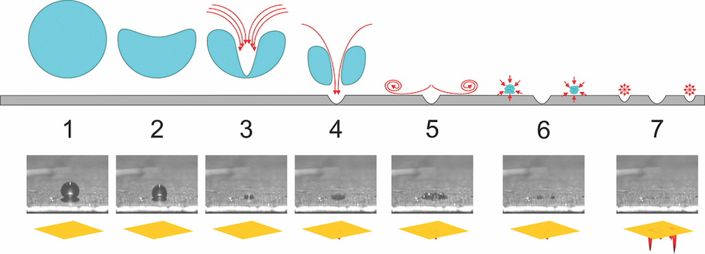

Figure 1: Cavitation of the entrained air bubbles. Figure reprinted from Wear, Vol. 418-419, Dular, M., Požar, T., Zevnik, J. and Petkovšek, R., “High speed observation of damage created by a collapse of a single cavitation bubble,” pp. 13-23, Copyright 2019, with permission from Elsevier/STLE
The cavitation noise is the sound of the entrained air bubbles collapsing under the sudden increased pressure as they go from the inlet to the discharge side of the pump. The oil bursts the air bubbles forming a jet of oil driving into the surface of the pump, eroding away metal, leading to premature pump failure (see Figure 1). The cavitation noise sounds like marbles or gravel flowing through the pump. It is quite noticeable. Supposedly aeration and cavitation sound differently in an operating hydraulic system. However, I have never been able to distinguish the difference. Cavitation also leads to foam formation in the system reservoir.
