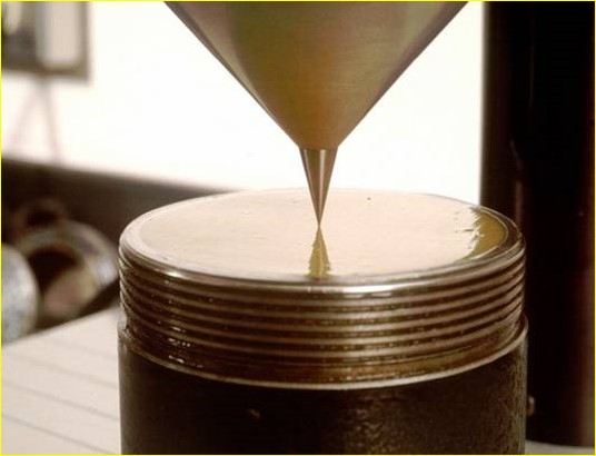

For applications that involve grease shearing, the D217 10,000 or 100,000 multi-stroke penetration tests and the D1831 Roll Stability Test provide an indication of how the grease will hold up under shear conditions.

For applications that involve grease shearing, the D217 10,000 or 100,000 multi-stroke penetration tests can provide an indication of how the grease will hold up under shear conditions. Courtesy: The Lubrizol Corporation/NLGI
