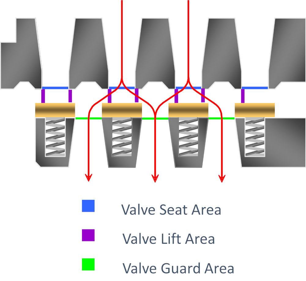

In traditional (legacy) valves, the gas must travel around corners, which causes efficiency decays due to pressure loss. However, in a modular reed valve, the gas path is unobstructed. Also, the differential pres­sure needed for a valve to open is considerably less in modular reed valves than in legacy valves. When these parameters combine with demonstrable life extensions, the overall advantages are difficult to ignore.

Considering modular reed valve design, the underlying design principle of a modular reed valve is captured in the term “straight-through flow” or StraightFlo. Although these valves are placed in the category “reed valves,” their use of high-performance polymers and truly modular elements of construction distinguish them from most other valves. at high velocity past two or more corners (see Figure 2).
Fig. 2: Traditional valves and depiction of flow. Courtesy: Zahroof Valves

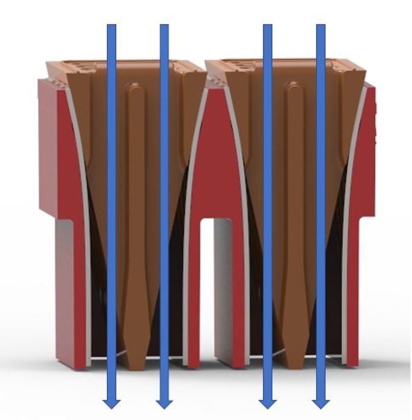

The StraightFlo valve has much lower pressure drop; it consistently results in power savings of 0.5% or higher (see Figure 3). The manufacturer submitted data from a highly instrumented case study indicat­ing a 41% reduction of power losses in the valves of a 1,000 hp integral gas engine compressor in natural gas service. Specific power (bhp/volume flow) was improved by 9.3% and similar results were achieved at other compressor stations.
Fig. 3: Two modular reed elements illustrating straight-through flow path. Courtesy: Zahroof Valves

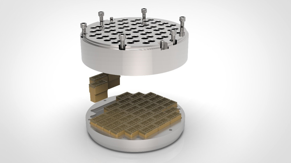

The inventor chose the generic term “modular reed valve” for compressor valves designed and constructed as depicted in several of our illustrations. Adaptations are available of different cages, stacked valve models, unloading mechanisms and other configurational choices. However, the high-performance plastic, reed-containing components depicted in Figure 1 are com­mon to all; even their external dimensions are identical. Where traditional valves experienced severe fouling, a StraightFlo drop-in replacement always showed con­siderably less fouling in the same time frame. Because of its largely self-cleaning action, the drop-in replace­ment greatly extends the run length capability of other valves. The novel valve concept allows field-cleaning by a relatively inexperienced labor force and usually takes less than 15 minutes.
We ascertained ease of service, improved compres­sor flowrates, servicing possible by lower skilled work­force members, above-average operating performance over a very wide speed range and generally well above-average availability/reliability. While the first applica­tions were in upstream facilities (oil exploration and gathering), StraightFlo valves have made significant inroads in downstream facilities such as oil refineries and petrochemical plants. The uniform construction of the valve internals facilitates spare parts procurement and management to an unusual degree.
