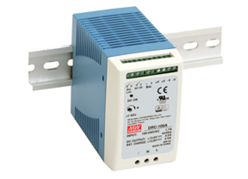

DRC-100 series rail mounting power supplies has an output power rating elevated to 100W. The series consists of two models with different output voltage levels. Both units can be assembled onto TS35/7.5 or TS35/15 DIN rails within an industrial cabinet.
The units both have universal inputs which accept 90 to 264vac or 127 to 370vdc. The DRC-100A has two 13.8V outputs, and DRC-100B delivers 27.6V from its two outputs. Protection functions include overload, over-voltage, battery low cut off and fused battery reverse polarity safeguard, the units also have relay contact alarm signals.
During a mains failure, the battery ensures continued power to the load until it is discharged or mains power is restored.
