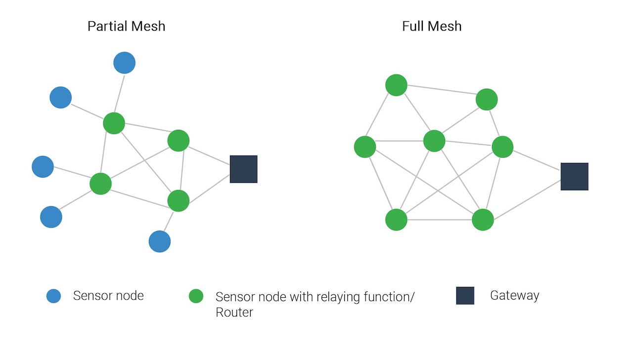

As the 2.4 GHz operations mode provides a very limited range of only 10 to 100 meters, these solutions resort to mesh topology to improve overall network footprint. Typically, a signal hops through multiple devices until it reaches the gateway. In full mesh networks like WirelessHART, all sensor nodes have the routing ability to relay data from other nodes. In partial mesh networks like Zigbee or ISA-100.11a, only selected nodes can act as routers.
Reliability in a mesh network is achieved through its self-healing capability. If a router or sensor node fails to function, the message can be re-routed through another path. To avoid package collisions and further improve robustness, approaches such as “listen before talk” or time-synchronized communications are employed.
