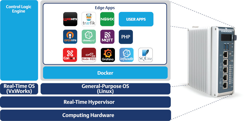

App-based edge architecture: For many users, a key edge controller feature is how many and what kind of general-purpose edge apps — over and above the core deterministic control function — are available for optimizing the process or machine control (See Figure 2). General-purpose apps may include any combination of:
  • Human-machine interface (HMI) machine visualization.
  • MQTT for cloud connectivity.
  • Node-RED for visually connecting data flows.
  • Grafana for analytics and interactive data dashboarding.
  • And many more!
Figure 2: The Emerson PACSystems RX3i CPL410 edge controller employs hardware virtualization to ensure performance and independence between RTOS control and general-purpose OS apps, which themselves are containerized using Docker.
Figure 2: The Emerson PACSystems RX3i CPL410 edge controller employs hardware virtualization to ensure performance and independence between RTOS control and general-purpose OS apps, which themselves are containerized using Docker. Courtesy: Emerson
These applications can be run normally under the GPOS. However, a more effective approach is to containerize these apps—bundling the app’s code with related files and dependencies — for best independence and control of inter-app communications. Just like hardware virtualization ensures each OS can be independently managed and even restarted, a containerization platform such as Docker provides these capabilities for apps, enabling users to test, deploy and scale up configurations.
