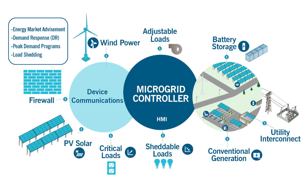

A microgrid meets needs
The are many options available to configure the best microsystem for an organization. Some of the best-known components are:
Photovoltaic (PV) solar arrays, which can be built onto existing roofs, structures or ground-mounted frames and tied into AC inverters, batteries and other electrical infrastructure comprising a microgrid. The power generated from the panels can be channeled and stored into energy storage battery banks or incorpo­rated with other power sources like generators and wind power via inverters that change dc to ac voltage.
When a grid outage occurs, a facility can operate without the grid, using the solar generation to power operations during the day, and store excess energy in batteries to continue into nighttime. Solar plus energy storage microgrid can provide cost savings when the grid is operating on-peak by shifting load to electricity stored during less expensive, off-peak hours.
Solar parking canopies: While covered parking provides vehicles protection from the elements, it can also be an overlooked area for onsite renewable power generation.
Onsite wind generation: Wind generation can be coupled with a battery energy storage system (BESS) to provide a robust onsite option for power generation — and an important contributor that helps organiza­tions meet their sustainability goals.
Courtesy: Duke Energy
Battery storage and UPS: A battery energy storage system (BESS) stores energy through battery technol­ogy. It can be a critical component in the microgrid system by acting as an energy buffer when intermittent renewable electricity generation creates new demands on the grid.
Main battery storage coupled with an uninterrupt­ible power supply (UPS) system can be used to provide sensitive computer controls and data center servers with the proper stable backup voltage and protection to keep IT and control system operations online.
Backup power generators: Conventional genera­tor systems can provide reliable backup power during unplanned outages. Generators can be combined with energy storage and on-site renewable energy to provide a comprehensive microgrid solution.
Fuel cells: If someone’s manufacturing operations have dependable access to natural gas, biogas or hydro­gen, fuel cells are a great option. Fuel cells can supply continuous power when wind, solar, batteries or other resources are unavailable.
In addition, fuel cells generate about half of the greenhouse gas emissions of centralized power and release virtually almost no carbon monoxide, lead, ground-level ozone, particulate matter, nitrogen diox­ide and sulfur dioxide, the six most common sources of air pollution. They also offer a high degree of cost predictability, making it possible to lock in long-term power costs instead of facing yearly utility rate uncer­tainty and increases.
Microgrid controls: Operation of the microgrid needs to be adaptable, depending on the power sup­ply from the grid, time-of-use rates, demand response agreements with the local utility and arbitrage where a deregulated market exists for selling off excess power.
A robust microgrid controls system will handle con­ditions in near real-time response and provide the required flexibility to accommodate dynamic opti­mization strategies as well as grow and change with future growth and power options.
