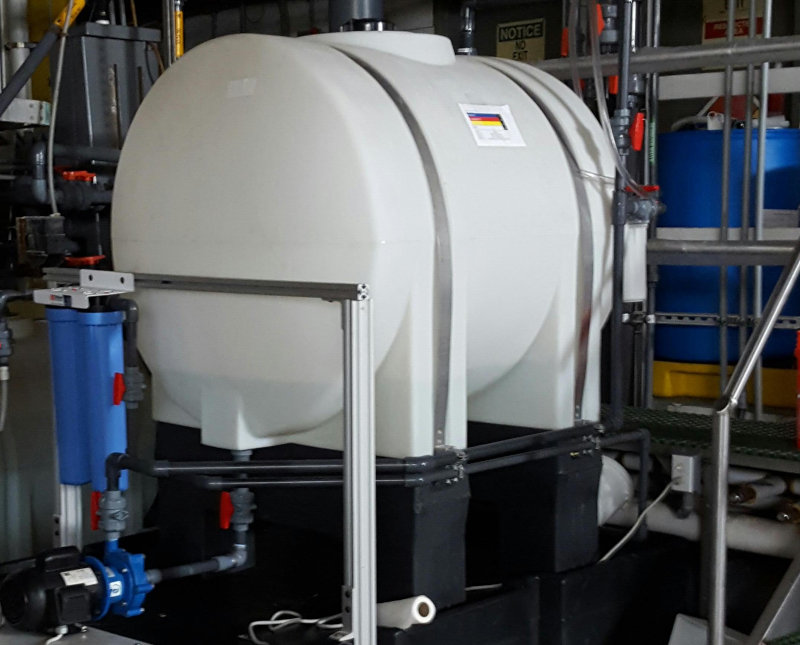

Flooded suction: For use when the fluid supply level is above the pump’s centerline or impeller eye. A storage tank feeding the pump from an outlet near the bottom is an example. Gravity enables the fluid to flow into the pump. Heavy-duty ANSI dimensional pumps, that conform to the flange and foot dimensional specifications in ANSI/ASME B73.1 and B73.3, also fall into this category.

Transfer chemicals from bulk storage to blending tanks
Circulate chemicals in blending tanks
Load/unload chemicals from trucks & rail cars
Load chemicals on filling machines
Transfer chemicals through piping within the plant
Rapidly empty batch treatment tanks
Transfer chemicals and rinse waters from sumps.
