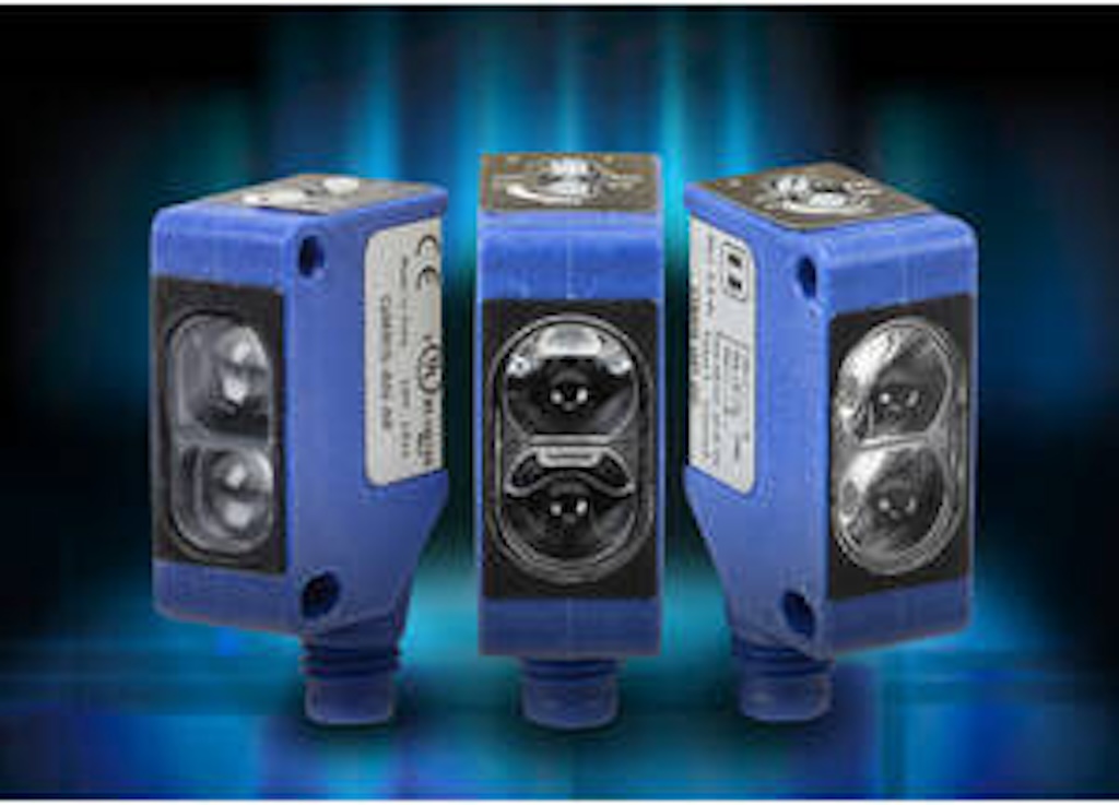

Photoelectric sensors insights
- Photoelectrics deliver performance in smaller packages, thanks to electronic miniaturization.
- When a 1,450 nm infrared sensing beam is used, water can absorb about 1,000 times more energy than at visible wavelengths resulting in a high-contrast application, with the clear bottle and clear water appearing differently to the sensor.

A photoelectric sensor with a 1450 nm infrared sensing beam, which is inherently absorbed by water, enables simple discrimination between a clear plastic bottle and the clear water it contains for accurate presence and level detection.
