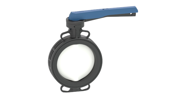

Butterfly valves are quarter-turn flow control or isolation devices, used for quick shut-off in piping systems. Four actuation methods are highlighted.
Butterfly valves are quarter-turn flow control or isolation devices, used for quick shut-off in piping systems. They have compact and lightweight designs that improve the coefficients of flow, limit pressure drops and enhance pressure recovery.
How does a butterfly valve work?
Control of the opening and closing of the valves, for isolation or throttling service, relies upon a centrally placed disc attached to a rod or shaft passing through it and connected externally to an actuator. Turning the actuator aligns the disc perpendicularly or parallel to the direction of the fluid flow.
Valve discs are of equal radial dimensions as the bore, and are continuously present in the flow – inducing a limited pressure drop in the system.
Butterfly valves are classified based on the disc closure type and the design of the ends of the valve body.

1. Manual valve operation
These are rudimentary, hand-operated actuators that use a wheel, crank, or lever to control the position of the stem and the disc. They are simple, inexpensive valve operating systems that are suitable for remote pipe systems without access to power. Some large valves contain a geared system for increased torque. Advanced, gear-operated actuators have analog indicators that correspond to the approximate positions of the disc.
This category of valve operation is limited for use with small-sized valves. Their operational speed is low, making them unsuitable for critical pipe systems.
