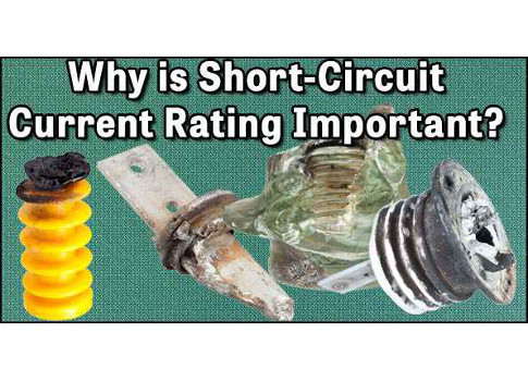

There are several problems with electrically powered equipment. One of them is a short circuit. However, prior to 2008 there was no definition of a short-circuit current rating in the NEC. Since this rating is now part of the NEC guidelines, it is important to verify and improve the short-circuit rating in order to remain in compliance.
Article 100 of the NEC defines a short-circuit rating as:
“The prospective symmetrical fault current at a nominal voltage to which an apparatus or system is able to be connected without sustaining damage exceeding defined acceptance criteria.”
In essence, a short-circuit current rating gives a baseline for the fault current that a piece of equipment or individual component within the equipment can withstand for a specific amount of time, or until it clears the circuit with a fuse or the opening of a circuit breaker. In newer equipment with higher short-circuit current ratings, this baseline is not much of an issue. However, it can be a problem in older equipment when the equipment is moved from one location to another.
