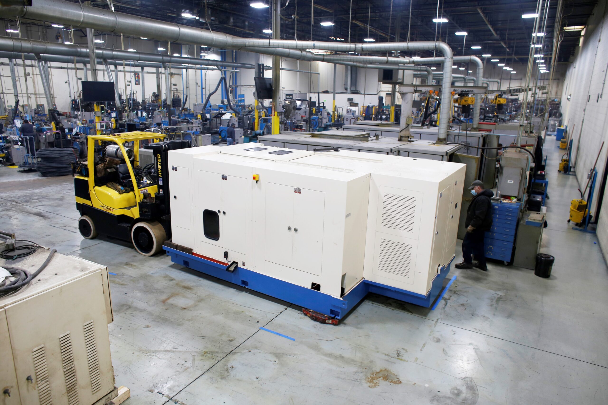

Figure 1: In 2021, Optimas Solutions added a Chun Zu four-die, four-blow cold header manufacturing machine that increased its capabilities to deliver larger format diameter fasteners and free up existing cold headers to provide more onshore support for smaller fasteners. Courtesy: Optimas Solutions

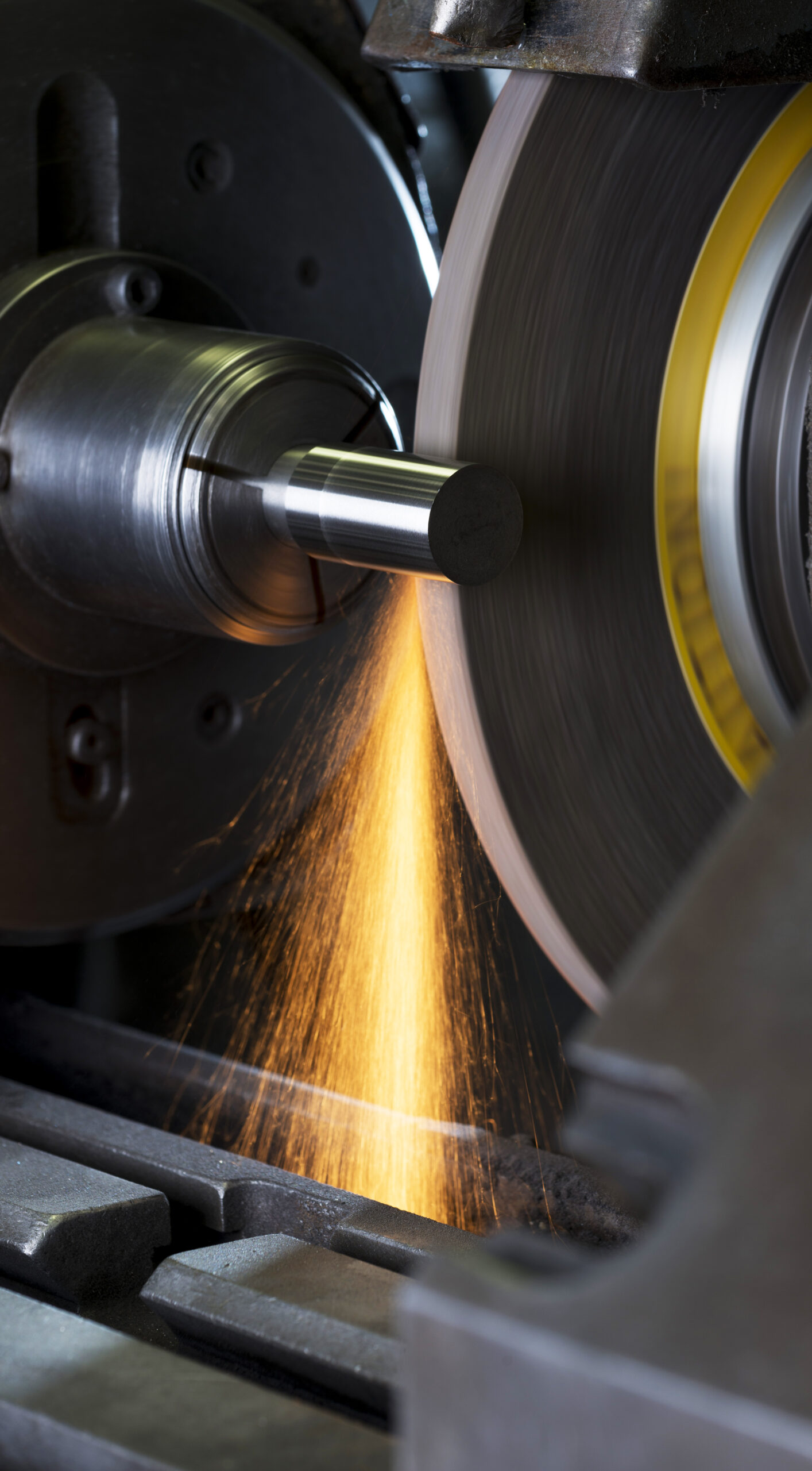

Figure 2: A lathe smooths a fastener during production at Optimas. Courtesy: Optimas Solutions
