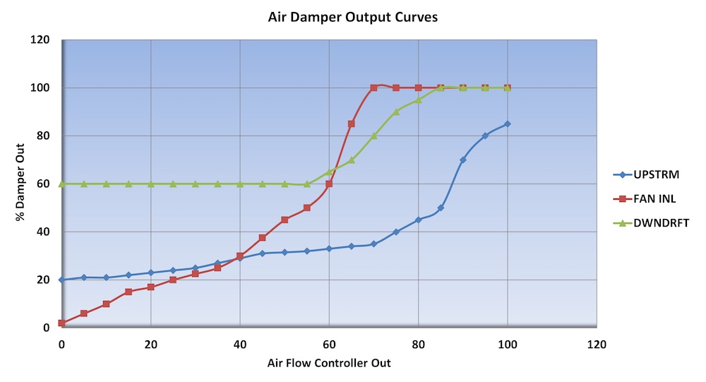

Air flow control/characterization
Gone are the simple days where a damper with a single speed fan controls air flow. Today’s modern boiler systems can have a variety of different air flow control devices and drives installed, including:
  • Fresh air damper: The first damper before the fan and flue gas recirculation (FGR) duct that regulates the amount of fresh air entering the process.
  • Fan inlet and outlet dampers: The dampers after the FGR combines before the windbox to help control airflow.
  • Boiler outlet damper: Often referred to as the stack damper, it properly directs water vapor and combustion gases out of the system.
  • FGR damper: Controls the recirculation of flue gases to lower nitrogen oxides (NOx) emissions.
  • Motor variable frequency drives (VFD): Motor speed controllers that automatically lower the motor speed when operating at lower loads to save energy.
Figure 2: Air damper output curves with variable frequency drive. Courtesy: Novaspect
Here are the steps of a normal air flow control tuning strategy:
  1. Use the boiler outlet damper to control the pressure, either just ahead of it in the boiler outlet or in the furnace. This pressure is the critical driver of flow through the FGR ducts making it critical for good NOx control.
  2. Position the FGR according to a curve based on the fuel flow. There are times when FGR flow is measured, then the curve gives the setpoint for the FGR flow controller.
  3. Then, group the other dampers and fan speed together, each with its own characterization curves to control air flow.
The critical tuning step for this is configuring the characterization of all the various air flow controlling dampers (usually three dampers and a motor speed). The best way to accomplish this is with the boiler offline while just running the fan. This gives the person tuning a chance to adjust each curve by simultaneously monitoring the air flow while stepping up the output of the flow controller in 5% or 10% increments.
Any proportional-integral-derivative control requires linearity to work throughout the control range and this is particularly critical in a boiler that will operate flows through the whole control range. With a VFD, the cost savings can come from opening the air dampers first and then ramping up the fan speed, but keeping the fan running as slow as possible.
Be aware: turning the fan too slow can lead to pulsations caused by the fan blades passing the fan scroll. Usually, 25-30 Hertz works as a minimum, but some boilers may require 40 Hertz or higher as a minimum. It really is a function of how the fan is designed, but pulsations in the outlet duct expansion joints will be an indicator the fan speed is too slow.

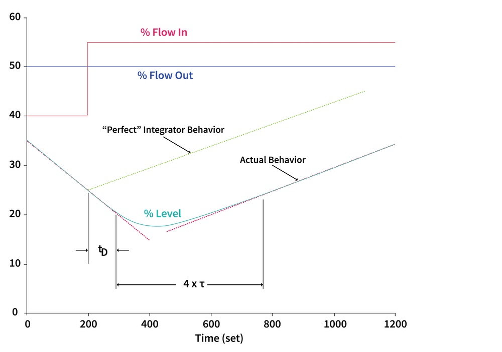

Boiler header pressure control
Plants will often have a pressure controller per boiler and the operator will assign each of them different setpoints so that one ramps up to full first and then the second one comes off minimum and starts to control pressure. This works, but by controlling all the load swings with one boiler, it increases the chances of that boiler tripping. It is better to have a coordinated plant master that sends the demand to each boiler and allows all boilers to operate together to control swings.
Like a three-element drum level control, the coordinated plant master is a common standard that should be easy to implement for any control system. Even with boilers that have their own standalone control system, they will have a “remove” mode to accept a signal from a remote source, which can be a good upgrade as it only takes a few input/output per boiler to configure this control.
An important fact to consider about plant master and drum level is that they often interfere with each other because they are both integrating processes with similar time constraints — i.e., one will start to swing and then the other will as well, especially if the integral times are too tight. Like with air and fuel, the best way to combat this is to use a tuning method to determine their close loop response time. This can help you gain some separation from the interference through separating response time.
Figure 4: Determining lag time from the process variable measurement (e.g., pressure, temperature, flow, pH, speed, etc.) change in direction. Courtesy: Novaspect
Another approach is to use a little derivative on the plant master. Many times, this will break that interaction and stabilize the entire process. To pick the derivative time, use a manual bump test to make the pressure first go down and then go back up. From the trend, take the difference from the time when the pressure starts to change its upward direction and the time when it has completely leveled out in the new direction. This should be the lag time and it is first order. If you divide that time by four, it should give you a good derivative time (shown as tau, or time, in Figure 4).
