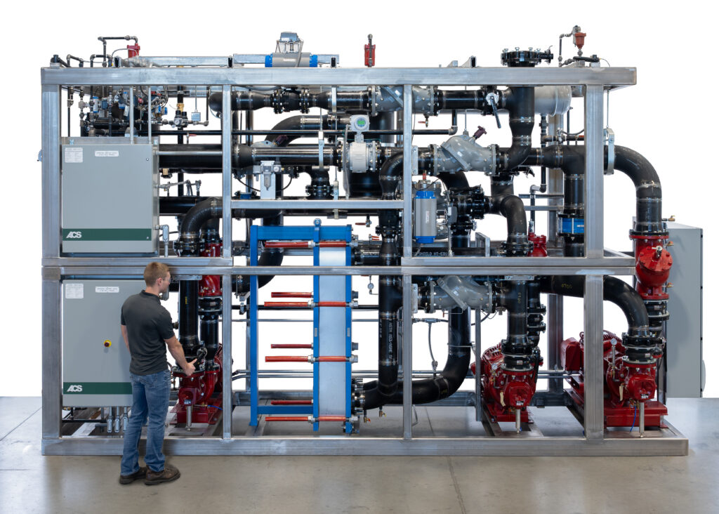

Figure 3: Integrated thermal management skids provide precise cooling to prevent thermal runaway and ensure battery cells operate at peak efficiency. Courtesy: ACS

  • Thermal management: Ensuring HVAC or liquid-cooling systems are functioning at peak efficiency to prevent thermal runaway.

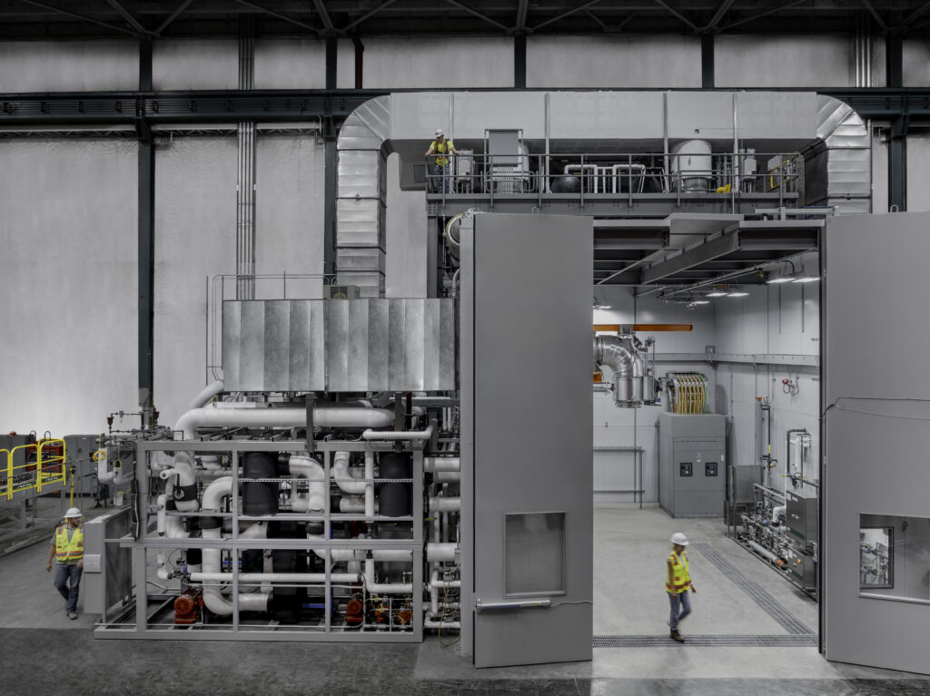

Figure 4: Genset test cells benefit from battery energy storage system (BESS) “buffering,” which maintains system voltage and frequency for sensitive electronic loads during high-stress testing cycles. Courtesy: ACS
