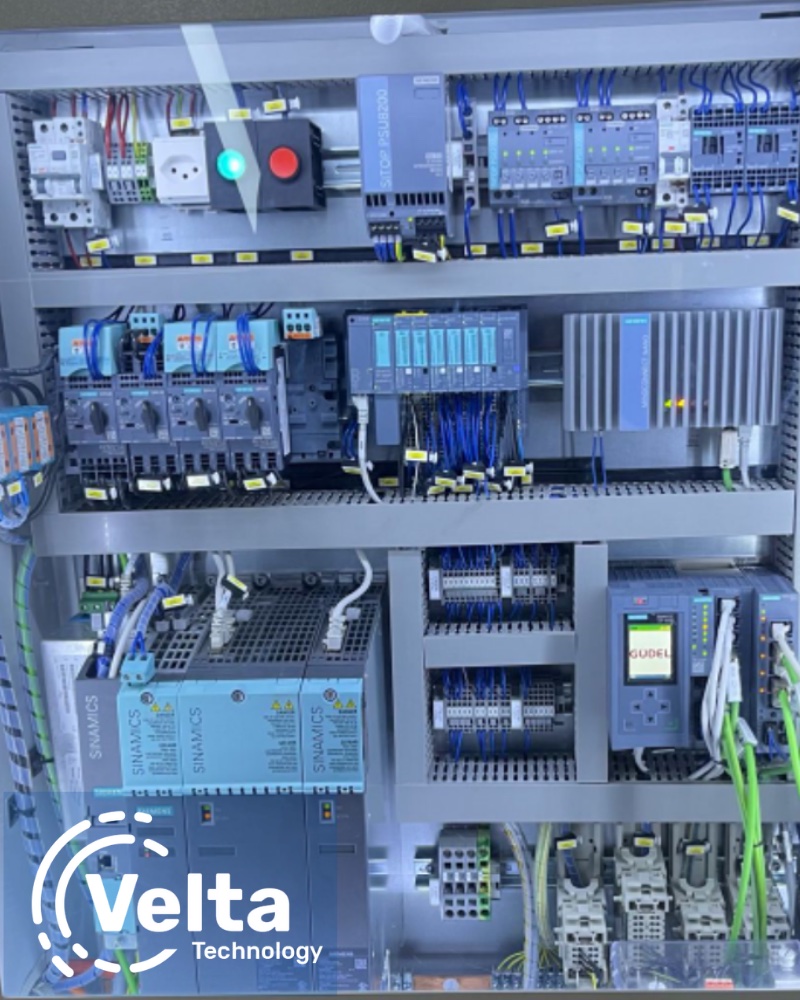

Haphazardly or unwittingly, IT is led to believe they are the defenders of ICS until someone shows them the actual ICS in question (see Figure 1). Once the ICS devices are finally brought into the light, IT will respond those ICS technologies on the plant floor are not in their scope. If not IT, then who is responsible for ICS cybersecurity?
Without any hesitation, IT would say they are responsible for the system application and product in processing (SAP), email, data centers and business networks. If IT does not see ICS equipment as in their scope, and OT is not stepping up to take ownership of their environment from a cybersecurity perspective, where does that leave things?

Figure 1: Asset visibility and network monitoring. Courtesy: Velta Technology
