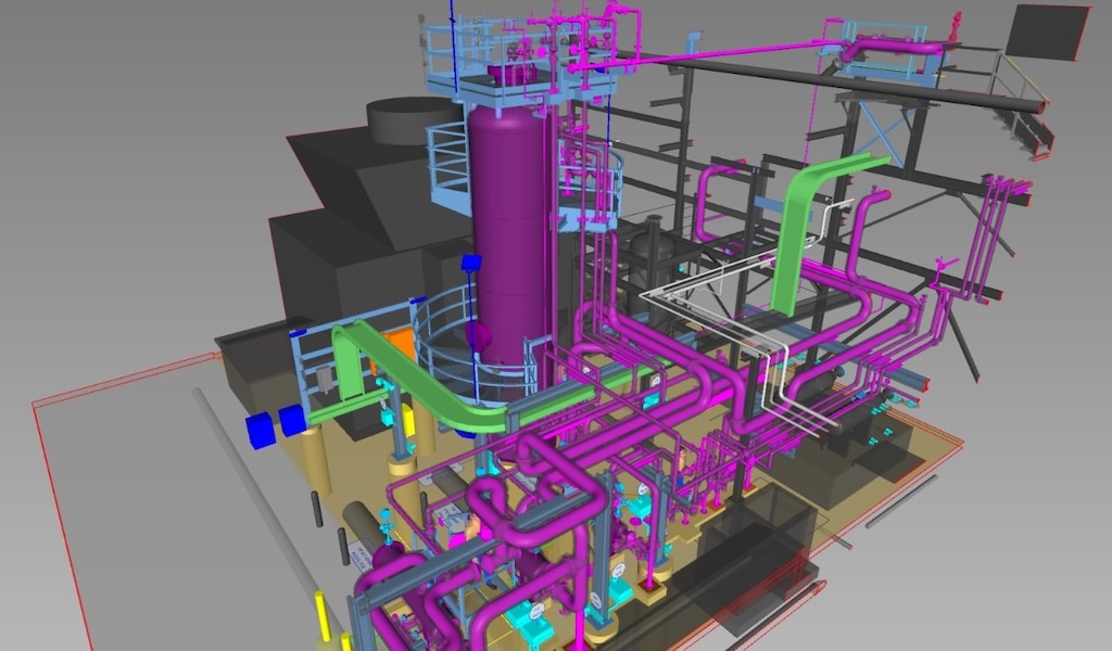

Figure 1: Proper piping design focuses on the equipment layout and all connections for optimal access for operation and maintenance. Courtesy: Matrix Technologies Inc.

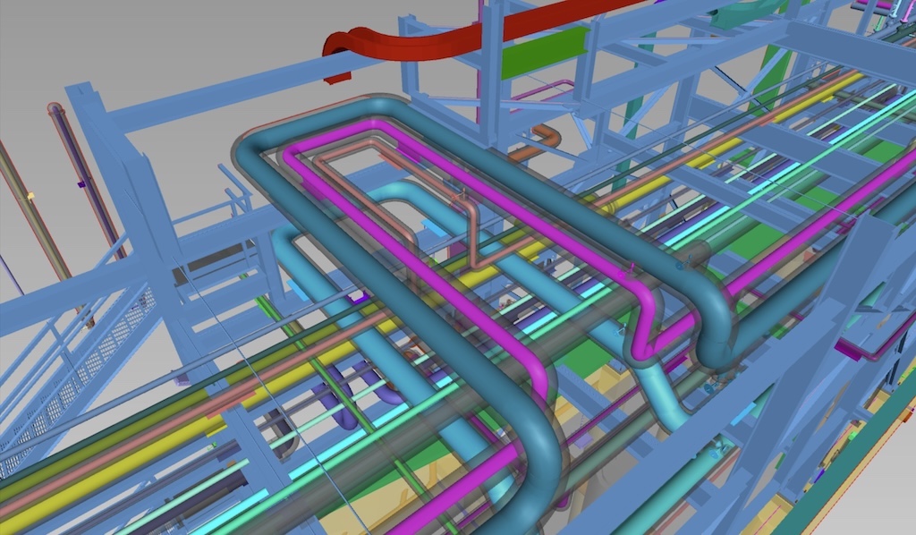

Figure 2: Process pipe designers allow for flexibility in their designs, like adding stress loops, pipe guides and anchors when needed to absorb or control pipe movement. Courtesy: Matrix Technologies Inc.
Routing and layout designs are scalable and can range from basic sketches to detailed fabrication drawings, the latter typically being scaled back to save on capital expenditures upfront. This can be effective but does expose the owner to risk of cost overruns during construction. The higher risks of requests for information to clarify gray areas while constructing, so planning for post issued for construction site assistance is typically warranted.

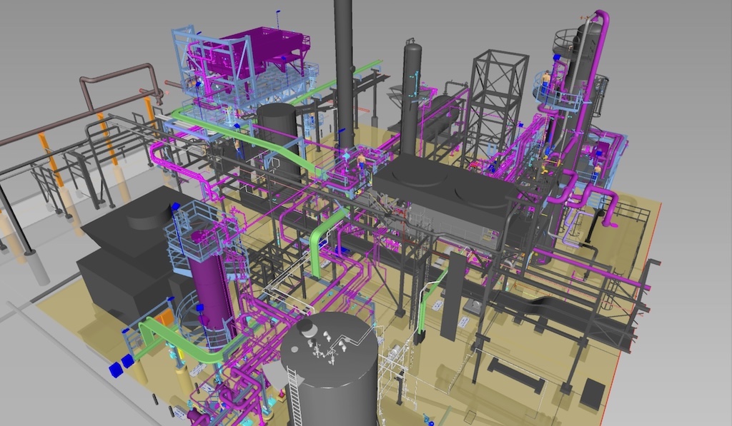

Figure 3: Plant or unit layout focus will minimize distance between tethered process and equipment, with consideration for minimizing long runs of costly high alloy pipe. Courtesy: Matrix Technologies Inc.

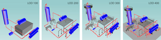

Figure 4: The acronym “LOD” can be used in different ways throughout the industries we serve and needs clarification when discussing. Level of design refers to the amount of detail in the 3D model. Level of detail refers to the amount of detail in the deliverable drawings. Thes are both common scales used to dial into project expectations. Courtesy: Matrix Technologies Inc.
These types of projects typically have very defined details and code-driven parameters. This could be cleanroom design, food and beverage or semiconductor projects that require specific design practices and adherence to codes. Other common examples would be cryogenic or super-heated lines that require strict finite element analysis to account for all stress needs of contraction and expansion of piping systems without overloading equipment connections while containing the process fluids safely.
