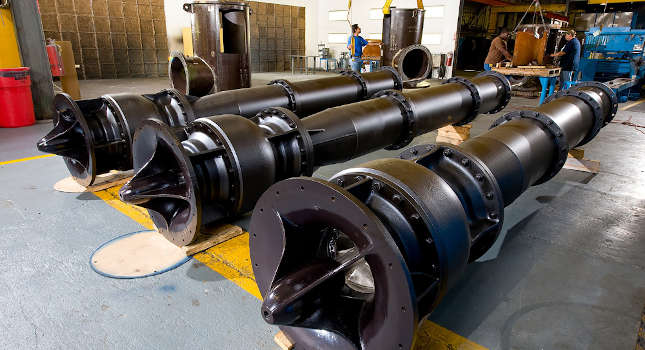

The vertical suspended pump can be overlooked when it comes to routine maintenance. The reliability of their design means that they rarely suffer from situations that attract attention. However, over time there is an expected gradual decline in efficiency as various components wear, which can be exacerbated if proper maintenance is not carried out.
Maintaining hydraulic alignment to the application is very important to the reliability and performance of the pump. Operating within a tolerance band either side of the best efficiency point (BEP) for the pump increases the resistance to failure. Moving away from this region can lead to increased vibration, reduced bearing life, reduced mechanical seal life, increased random failures and a reduction in overall pump life.

Clearly, after many years in service, pump components will wear and eventually need to be replaced. At this point it is important to understand the difference between replicated and re-engineered parts as well as how the advances in materials, design analysis and manufacturing processes have enabled new parts to deliver increased performance and reliability.
Merely replicating an existing part can lead to reduced efficiency, early bearing and seal failures, as well as increased vibration. These issues can arise because a lack of design engineering means as-new dimensions are not achieved, the surface finish is below standard and clearances are sub-optimal.
By using the original part as a starting point and applying current engineering standards to enhance the design, it is possible to create a new part that has the best hydraulic profile for the application. Minor alterations can also enable improved bearing and seal designs to be incorporated as part of the project, extending service life and reducing maintenance costs.
