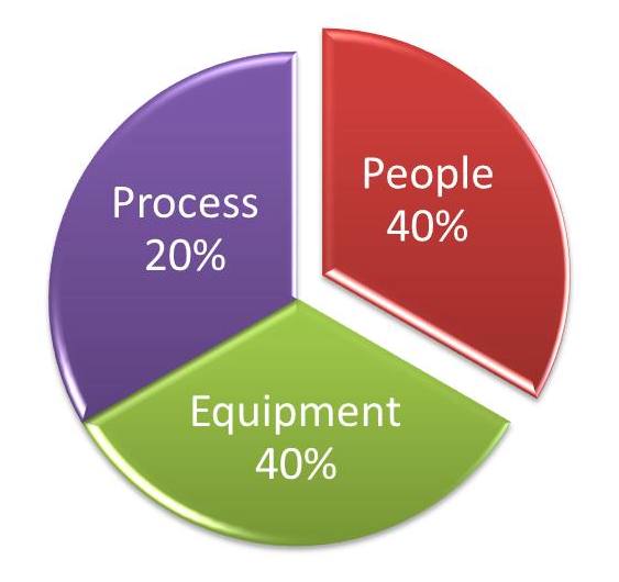

The consortium’s research estimates the cost of incidents to equal 3% to 8% of a company’s production throughput, which makes finding a solution to these problems paramount.
Preventable factors such as an employee and work environment account for 42% of incidents. On average, between 70% and 80% of equipment problems are a result of incorrect operation of equipment. Further, the UK Health and Safety Executive, an independent watchdog organization, reports human performance impacts 70% to 80% of abnormal situations.
Recognizing that human performance is an integral component of reducing the impact of abnormal situations, the consortium focuses on understanding the implications of human performance in process operations.
