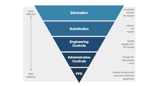

A key tool to use when attempting to make electrical safety in the workplace more robust is the hierarchy of controls. The five hierarchy tiers start at the bottom with the controls perceived to be the least innately effective and move up to those considered the most effective methods of hazard prevention (See figure 1).

Engineering controls increase effectiveness
Engineering controls represent the middle tier of the hierarchy, more effective than PPE and administrative controls, but technically less effective than elimination and substitution. However, equipment within and above this level is developed so as to design-out hazards, with engineering controls thereby taking on an increased level of effectiveness.

Evaluating robustness
While elimination or substitution are theoretically the most effective prevention methods, they’re rarely the most practical, and often, not achievable.
For example, inherent risk exists in opening an energized electrical enclosure, but performing service work without power to the equipment prohibits diagnosing or monitoring the equipment.
Working up the hierarchy of controls pyramid, the next option is “substitution,” the second most effective hazard control. Substitution involves replacing something that produces a hazard with something that does not produce a hazard.
An example of this is arc-resistant equipment. Rather than using traditional equipment such as switchgear and motor-control centers (MCCs), arc-resistant versions of this equipment can be specified and installed in place. This substitution incorporates arc-resistant material and reduces exposure to an arc flash hazard by directing the energy away from a worker performing a task, such as operating or racking a circuit breaker in or out with the doors closed.
Since “elimination” is the most effective way method to design out hazards, the easy answer would be to completely remove any energy within the electrical enclosure. Unfortunately, in this case, removing all energy from the enclosure is prohibitive to diagnosing or monitoring the equipment within and therefore, elimination usually is not feasible when it comes to electrical work on a plant floor.
