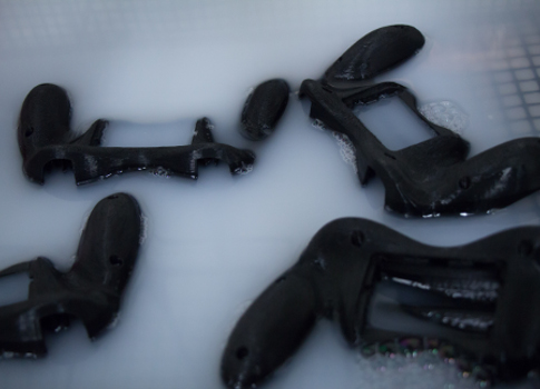

One of the most popular types of 3D printing is fuse deposit modeling, or FDM. The FDM process uses a machine to put down droplet-sized beads of a resin material onto a support material that acts like a placeholder. The resin deposits are made from the bottom up, layer after layer, and they fuse together to slowly build the form of a cohesive 3D end product. Manufacturers can digitally design intricate or complex products and produce them using 3D printing, eliminating the need for assembly.
Once the assembly is built, the mold support must be removed without damaging the actual designed part. The molds are water soluble, so dissolving one requires the proper detergent, time, and preferably some agitation to penetrate the solute as well as speed up the process. Ultrasonic cleaning naturally lends itself to efficiently and easily removing the support structure from 3D-printed parts.
Ultrasonic cleaners use environmentally friendly, nontoxic and nonflammable, water-based cleaning soaps and ultrasound waves to produce millions of microscopic bubbles per second. Energy is released by the creation and collapse of these bubbles, called cavitation, and the resultant shock waves break up and methodically remove support material from 3D prototyped parts, one layer at a time. The more complicated the part, the more effective the ultrasound is at removing the support material from blind and threaded holes.
