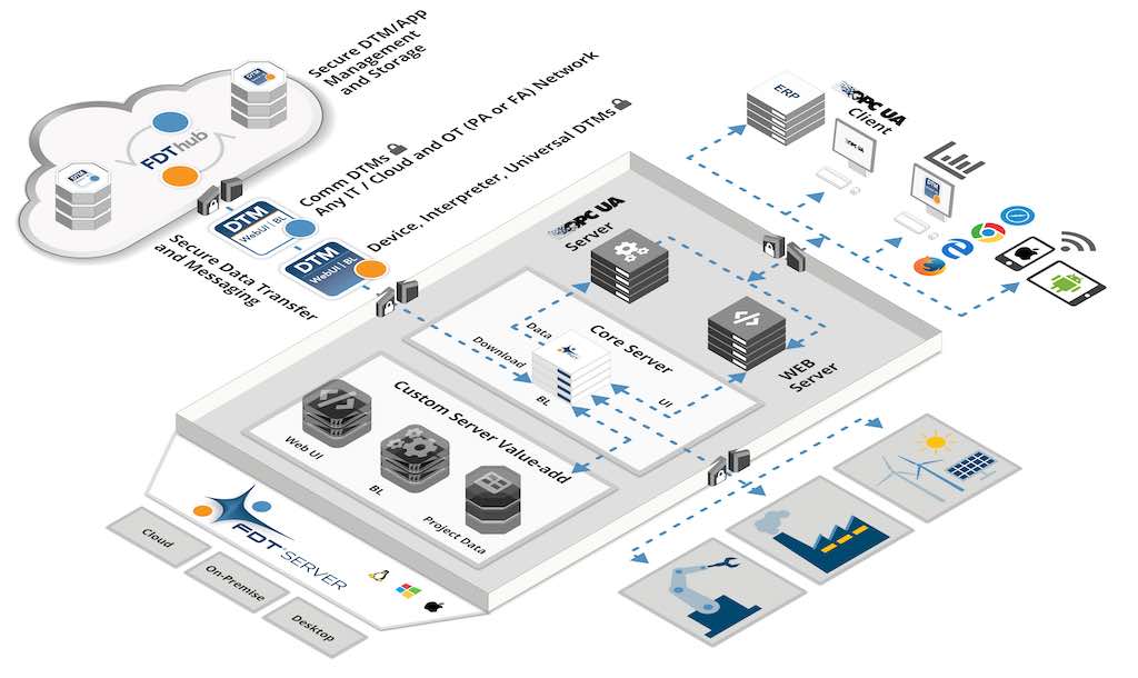

Figure 1: FDT 3.0 Server – Distributed Architecture. Courtesy: FDT Group
FDT 3.0’s native integration of the OPC Unified Architecture (OPC UA) and mobile remote access capabilities will have a significant impact on plant and factory maintenance personnel, who are looking for condition-based maintenance solutions to reduce their cost for periodic, scheduled repair, and troubleshooting activities.
At the core of FDT 3.0 technology is the FDT Server, which natively integrates an OPC UA Server for enterprise-wide data access and a web server mobilizing remote operations. This innovative solution transforms asset management practices and business system integration for both automation suppliers and end-users.

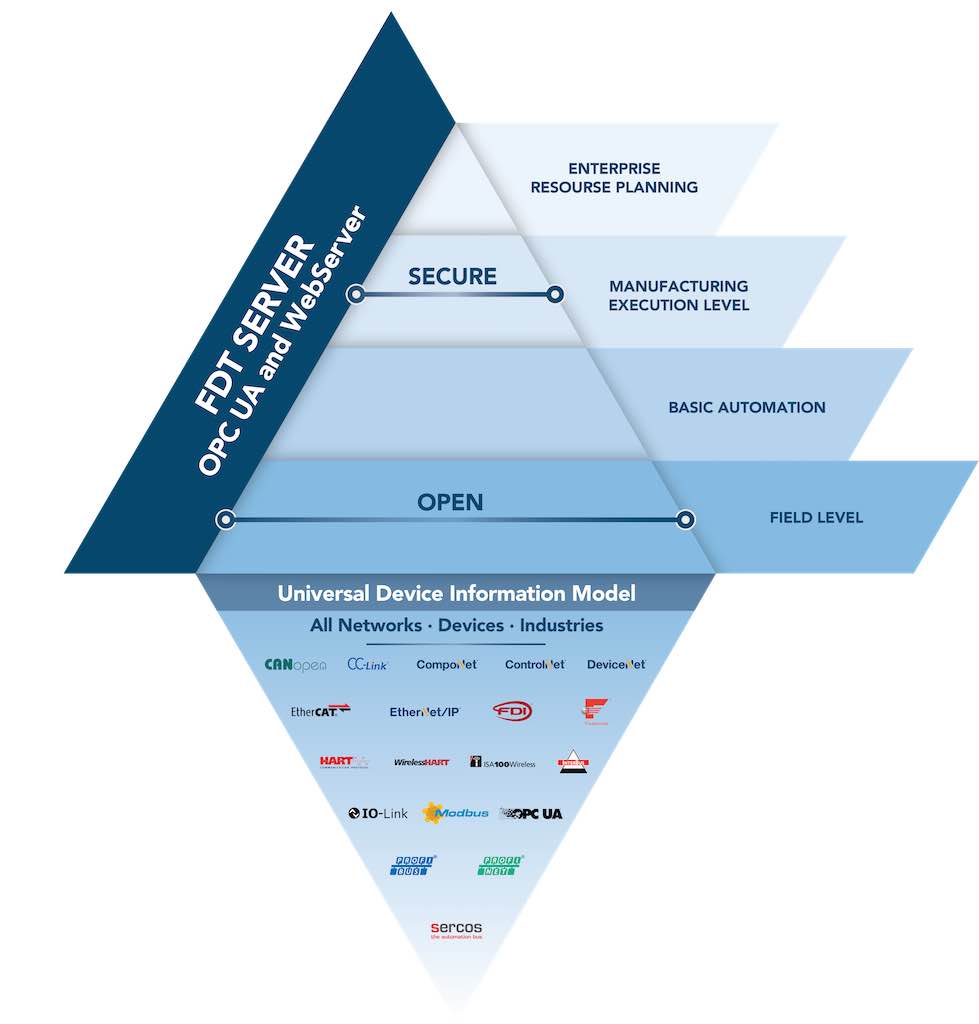

Figure 2: The FDT Server solution encompasses a Universal Device Information Model for seamless integration and communication enhancing monitoring and optimization practices. Courtesy: FDT Group
The latest advancements in FDT technology will drive a wide range of worker mobility apps tailored to information technology/operational technology (IT/OT) assets. Industrial operating companies can now employ the familiar functionality of the integration standard on common mobile platforms. This will provide access to additional data from any location with flexible deployment options.
