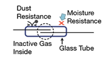

reed switch is a magnetic reaction-type switch containing two small Fe-Ni (iron-nickel) alloy plates. As illustrated in Figure 1, reed switches can be encased within a glass tube filled with an inactive gas, reducing the metal fatigue risk of the reed switch and prolonging its life. An encased reed switch is resistant to dust and moisture, as well as being corrosion resistant and explosion proof.

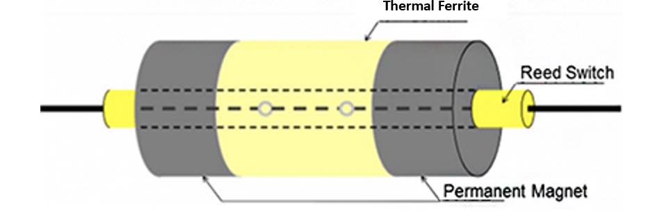

Engineers can choose between two types of thermal reed switches: Break-type and make-type. Both consist of thermal ferrite, a reed switch, and a permanent magnet. The reed switch is opened or closed based on the changing magnetic properties of the thermal ferrite as the temperature changes.

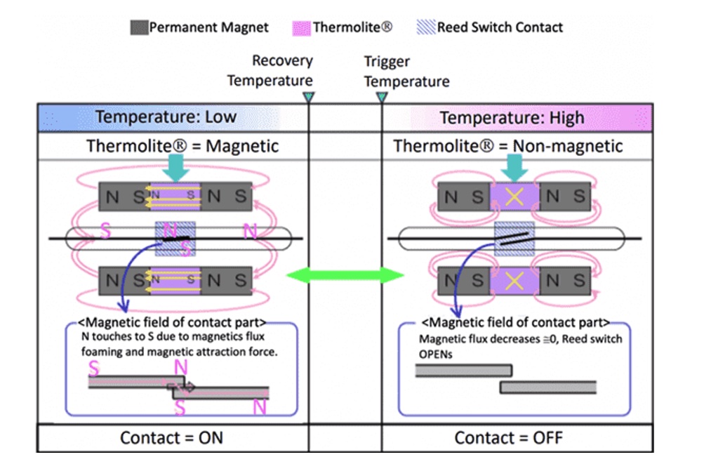

Figure 2 illustrates a break-type switch, which is normally closed. The switch remains closed (ON) if the operating temperature does not exceed a trigger temperature. It opens (OFF) when the temperature increases to a level equal to or higher than the trigger temperature.

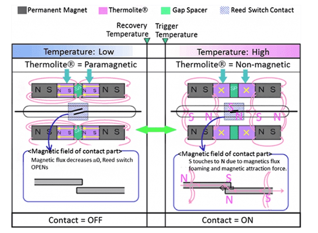

Figure 3 illustrates a make-type switch. Make-type switches are open (OFF) when the operating temperature is lower than the trigger temperature. The switch closes (ON) when the operating temperature becomes higher than the Trigger temperature.

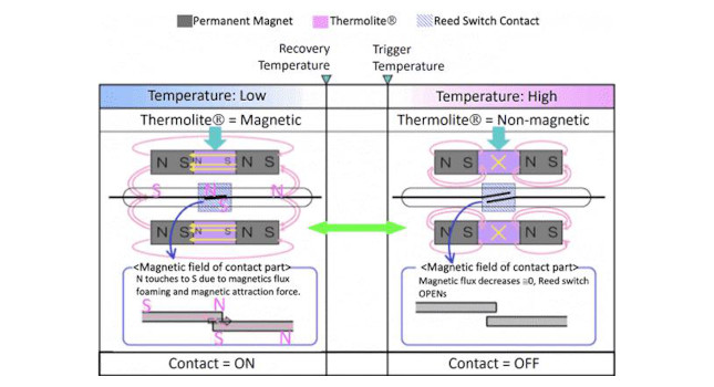

Figure 3 also illustrates the operation mechanism of a break-type switch. An annular magnetic field is generated by the thermal ferrite at temperatures lower than the Curie temperature. This magnetic field induces N and S polarity in the contacts within the reed switch and creates a magnetic attraction force that makes the tips of the contacts touch, putting the switch into the closed or ON state.
When the temperature of the thermal ferrite reaches the Curie temperature, it loses its magnetic flux and becomes non-magnetic. Because the magnetic attraction force is no longer present, the tips of the contacts open, putting the switch into the OFF state.

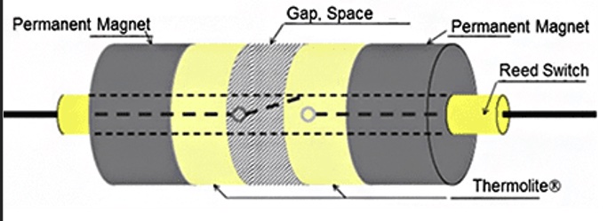

The difference between a make-type and a break-type switch is the addition of a Gap Spacer between two sections of thermal ferrite. If the temperature does not exceed the trigger temperature, it generates a magnetic field that separates the contacts in the reed switch. When the temperature reaches the trigger point, it becomes non-magnetic. N and S polarity is induced in the contacts of the reed switch by the permanent magnets, creating a magnetic attraction force that causes the tips of the contacts to touch, closing the switch (ON).
Figure 5 illustrates the operation mechanism of a make-type sensor.
