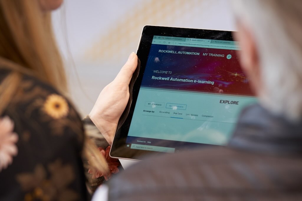

Figure 1: Virtual training can help build worker competency so they can be productive while following safety procedures.
Figure 1: Virtual training can help build worker competency so they can be productive while following safety procedures. Courtesy: Rockwell Automation

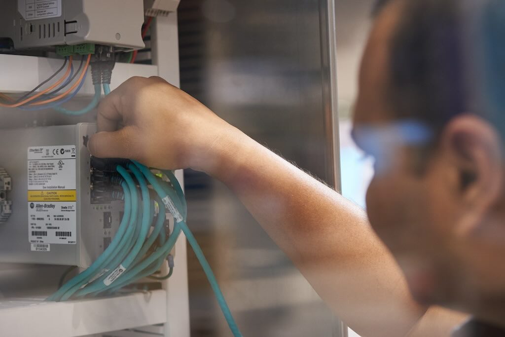

Figure 2: Smart safety devices can help managers use data to schedule device tests when needed to help maintain compliance.
Figure 2: Smart safety devices can help managers use data to schedule device tests when needed to help maintain compliance. Courtesy: Rockwell Automation
