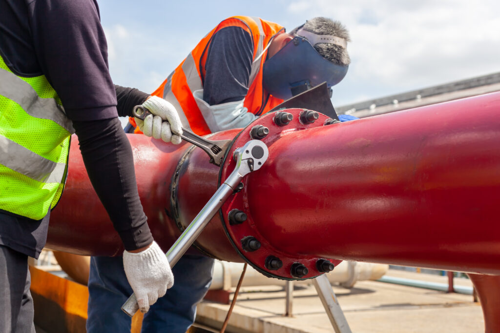

A worker installing and tightening bolts and nuts of a flange system. Courtesy: Teadit
